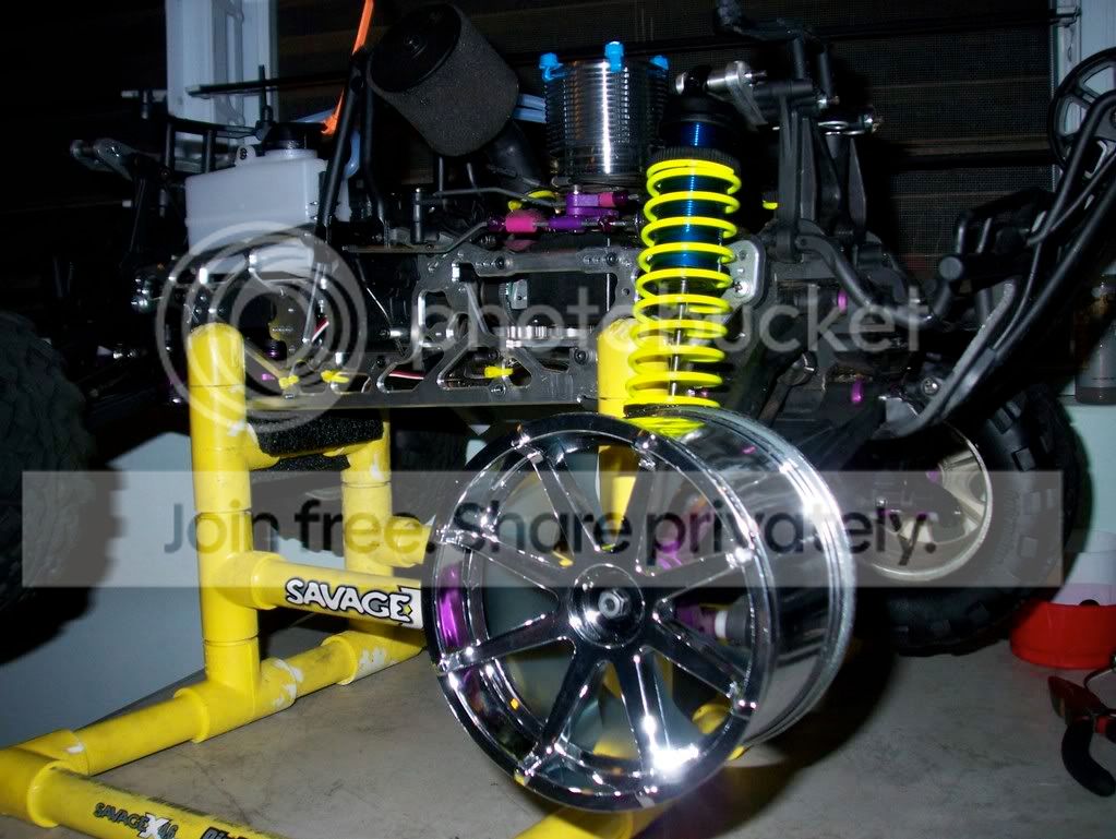

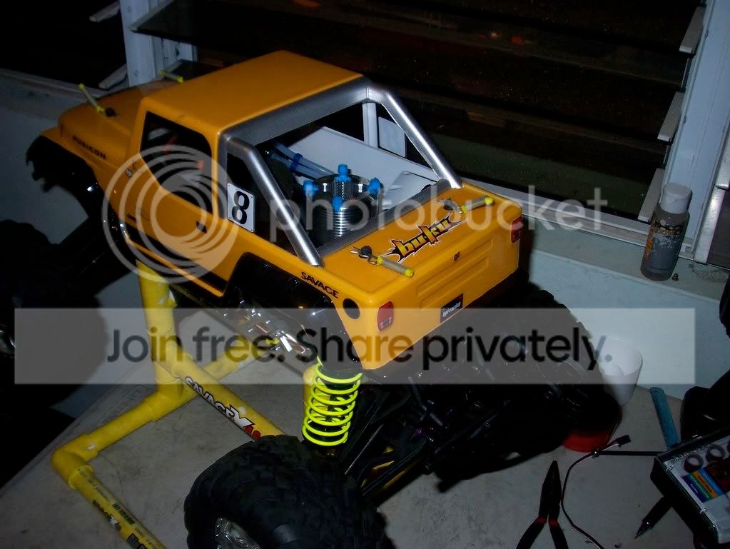

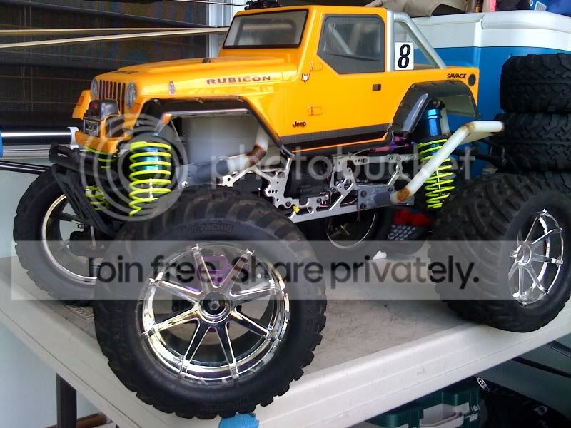

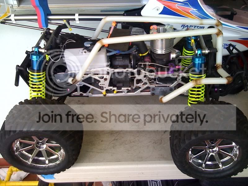

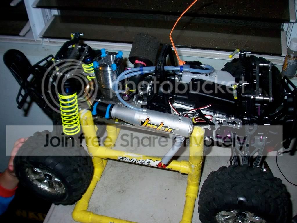

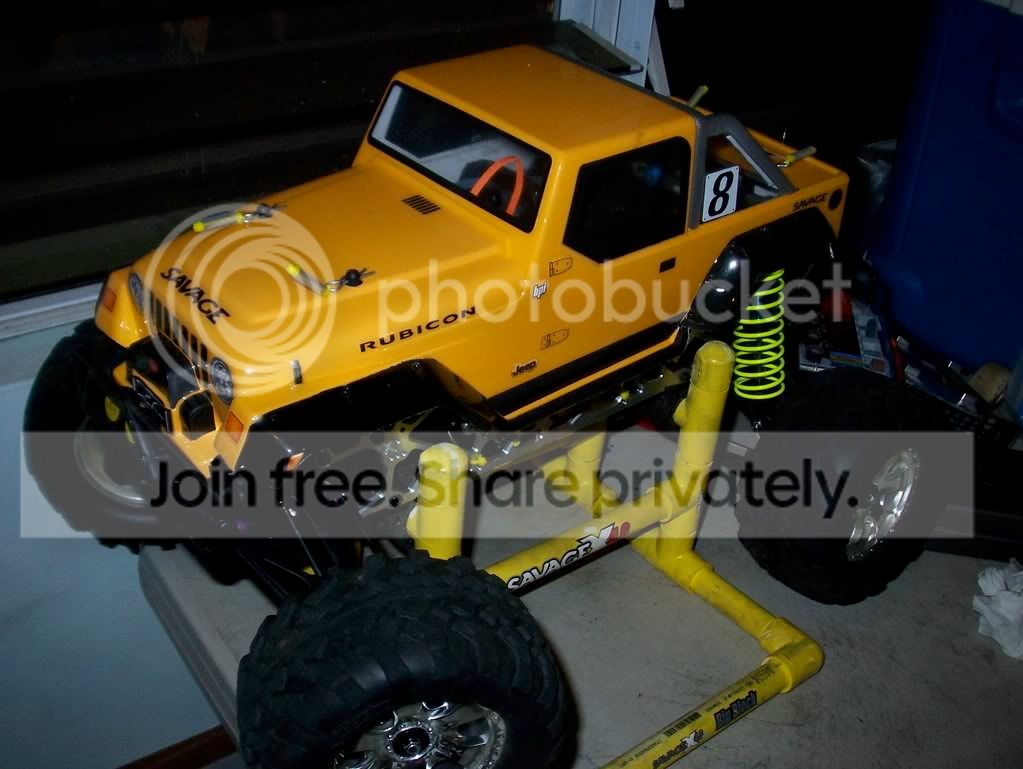

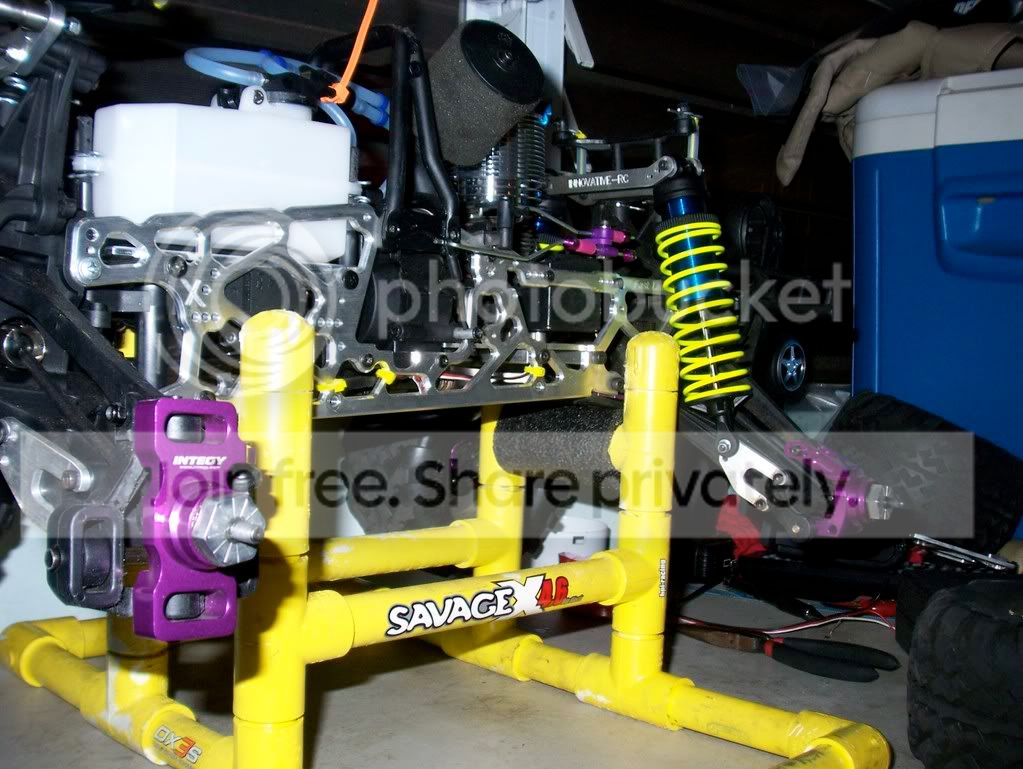

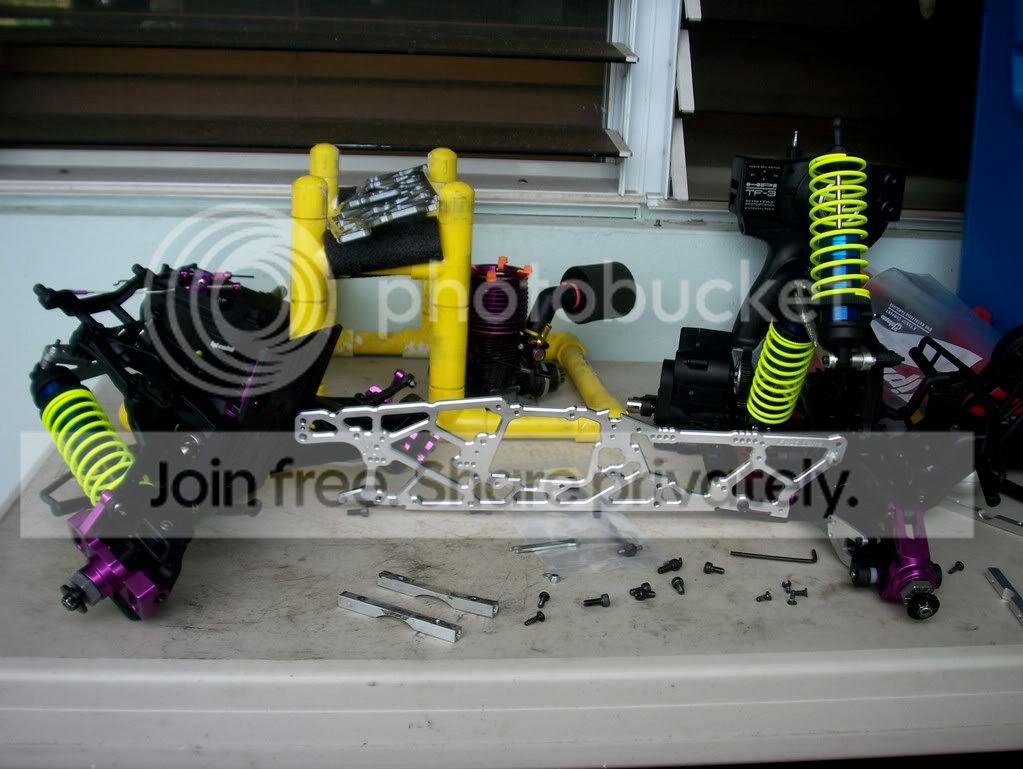

Here are some pictures from the build
Very nice looking truck man. Your 14.3#'s still seems heavy. My Savage Basher with PRC Ext LCG TVPs, FLM Motor plate, LST2 Full aluminum shocks w/inst. kit, and my PRC125 OFNA 250cc mid tank full of fuel, with my 1/2" offset Maximizer Beadlocks wrapped in Zombie-maxx tires with 3 speed Trans is only 12.9#'s remember thats with a full 250cc fuel tank and body.

Man, I keep looking at your pictures. I love your build it looks so sweet. You did a great job on your MT setup and I love the way and how clean your OFNA Throttle mod is.

The final numbers are in. Officially my Savage is 16 pounds/7.26Kg. And I removed the wheely bar thinking that might shave off some, how naive I am.
Here are some pics of it.
all the integy parts, buku pipe, cooling head also add weight...
the biggest difference in weight with the LST kit isnt the actual shocks, its the adapter kit, at least in the 5mm kit like i got, it definetly wasnt too light..
that roll cage or whatever you want to call it is wickeddd though. sign me up for one😛
