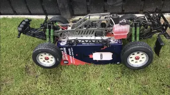

Got a bit more done to the truck,
Got the engine mounted, driveshafts made up and welded,
All the throttle and brake linkages put on,
Relocated the receiver box and redone the steering that used to be attached to the bottom of the receiver box,
053 Pipe mounted,
Ofna wheel extenders fitted front and rear,
Front and rear body mounts and new skid plates from super 5sc,
Just to extend the steering linkage and fit the side body mounts,
Paint and sticker up the body,
An hopefully try it out next weekend
I've a modded lrp30 motor I may fit to this truck as its nearly too much in my lst2,

Got the truck finished today,
All ready for a test run this weekend,
Changed the wheels to kyosho Strr spoked wheels with losi super kingpin tyres,
But might run with the Trenchers,

Interested in how you welded the driveshafts!
I thought a conversion like this would come with the driveshafts the right size? Or is this a custom kinda conversion?
The driveshafts are cut dog bones spliced with hollow steel tube and gas brazed,
they are very light weight and really strong,
I’ve tried bending them and the original
dogbone at each end start to bend without any issues with the brass rod braze welds
I just bought the brushless chassis plates from eBay on their own,
and had to remove material, drill and file to convert to nitro,
But would very easily convert back to brushless,
