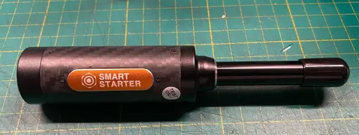

A glow starter that actually works. And keeps on working! 🤩

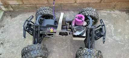

Check your old engine. It may look like this inside.

Horatio where did you get that Smart glow starter from are you in South Africa? do you import your nitro fuel from my side of the world being England?

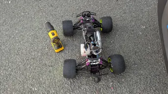

Engine temps were good - STS was 262°F and Novarossi was 260°F.
More than anything, I'm super impressed with how drivable the Savage is at speed, the cornering and how nimble it is. It's not just a straight line machine. It's still a Revo killer. It would literally eat rival MT's on grass tracks in the UK - and it still would! 😎

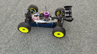

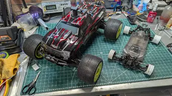

The vintage Savage next to an all carbon 22x-4 Elite.

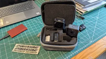

Amazing how stable the footage is with camera fixed to body shell I take it, what camera are you using?
The video is stabilised and I generally run 4k @ 30 FPS, although I could probably up that to 60 FPS.
I use a DJI Action Cam 2, with DJI mounts. The one that's great for RC cars is like a gummy ultra high bond, which is perfect for lexan.
Obviously, on tarmac, the way you drive has to be considered with a £300 camera perched on top, so I use a magnetic case for protection.
I like to use filters in bright weather, but as they just hold on with magnets, if the protective case is already fitted, the filters aren't held firmly enough for RC cars or drone use.

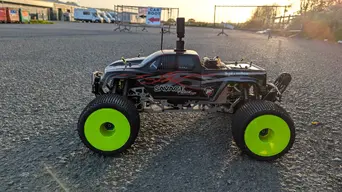

I'm just super impressed with how stable the Savage is. It corners like a touring car! 🤣👍
This is why I never ended up fitting anti roll bars. 🤔 But - I'd be very interested to see if they improve the handling without impacting the balance of the rig?
