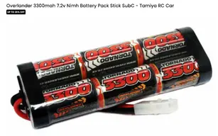

Odds are you'll need a new hump battery in the Savage (and batteries for the controller).
A battery for the Roto-start (if you have one)

Thank you. Yeah the air filter foam is shot. I've tried charging the battery in the roto-start, but after a few hours charge it seems to only hold a very minimal amount of charge, so assuming that is dead. Could the yellow wires have been used as a lazy way of charging the hump battery in the past?

Batteries - Yeah, replace them. They just don't stand the test of (attic) time.
Even if "they take a charge" (unless they're only like a year or two old), you don't want them failing while you're trying to have fun.
