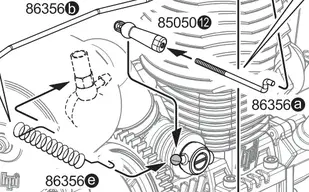

If you cant get a spring(1st choice i should say, spring is way better), a rubberband works. I put one on my buggy, turned on the radio, and unplugged my pack. It yanked the carb closed
Thanks a lot for the information, i will look at getting the spring I don't want another runaway truck
