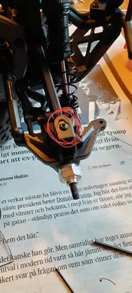

you can make an inexpensive wheel balancer from an axle, hub and lower control arm. glue everything straight and screw it to bench
I bought new wheels and balanced then 2 of 4 didnt need balancing. Huge difference
So took out the Savage for the first time on its new balanced Louise MT Rocks 2.8" and it was like completely new car, full control.
