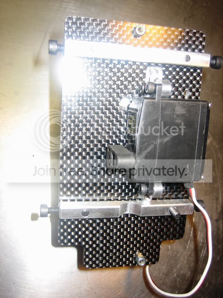

I am working on a 250cc mid tank using Larsens cf kit. this is what I have so far. Where I am stuck is. What would be good to use to link the servero to the bell crank? I was thinking of using tie rod ends and cutting the rod down to fit.
edit* sorry for the bad pic. all i had handy was the cell phone
Hello Prophet, If you turn the servo around the opposite direction you can use the original Linkage or make one of your own with higher quality materials of the same length to remove any extra slop.
