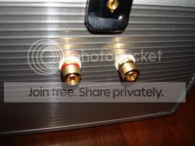

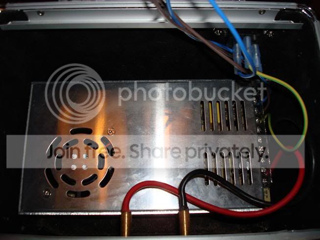

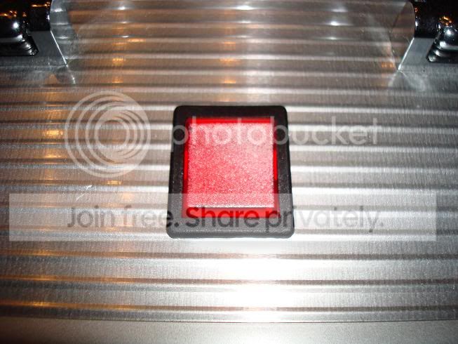

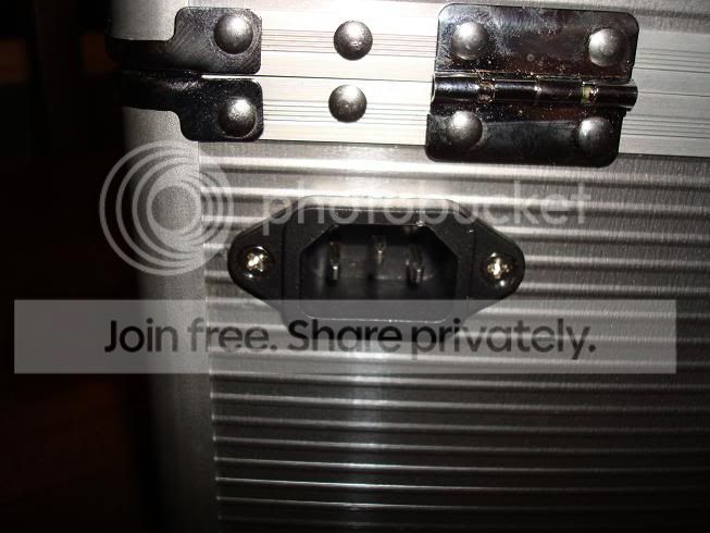

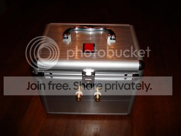

If you go to ebay.com you can find cheap power supply's made for server racks, computers, DIY machines and so on. You can find anything from 3volt and up! I bought a 25 volt switching power supply for my hyperion EOS0615I Duo3 and made myself a handy box that can hold the power cord and has a nice handle so I can take it with me where ever I need it!
