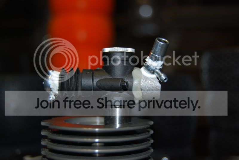

From what I recall, the Picco 28's were pretty known for carb air leaks. Some folks were pretty adamant that the carbs leaked bad around the slide and where the composite/aluminum was bonded on the HSN side. Usually once the engine got up to operating temp. People would use JB weld around the seam there and use Racers Edge sealant (which is supposedly 3 Bond Silicone ) around the boot and HSN around the banjo fitting. I usually use Permatex Sensor Safe Copper Sealant to seal up my carbs, but I don't usually put anything on the boot. Just the HSN banjo fitting, carb neck and back plate.
This is someones sealing job using jb-weld and the racers edge stuff on a picco carb:
