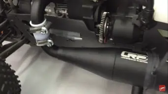

2) using a new exhaust pipe , comes in some last models of the Savage XL Octane as an limited offer as free getting the LRP Mielke Reso included ein the HPI Savage XL Octane Box
The new LRP Mielke Reso is more silent as the Original and give the Savage more power and an better deep tone sound which better fit to the Savage XL Octane „Beast „

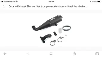

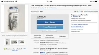

You can buy these LRP Mielke Pipe Today in EBay, you Must Look in Germany or Australien EBay and you Can find them

As I know, the first Octane are delivered with the black exhaust, later they change to the Silver Version.
The tuning exhaust, which I show in some of the files above, are the LRP Exhaust in Black with litte more power and an deeper Sound
