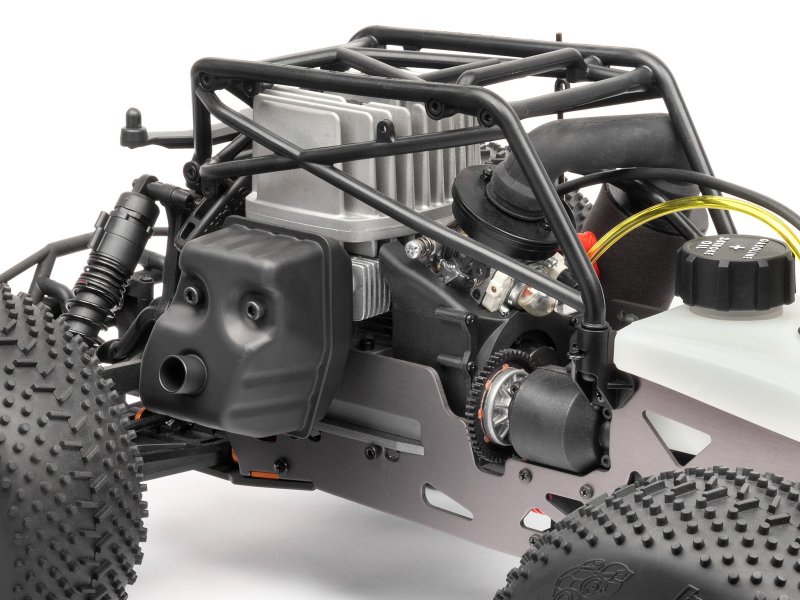

I recently picked up an Octane with a jacked up motor. I've been using parts from the truck as needed for the one that runs but I was wondering how hard it would be to convert the one that doesn't run into something like a flux? Any ideas?

Anyways the situation is i have a broken Savage Octane (I am not sure what is really broken, it might be the engine, the CDI or anything- The distributor has no clue!) and I really need some sort of guide to convert it to electric.
When you suggest this:
single speed tranny, new spur/pinion, motor mount, battery mount, and find a place to put the esc
Do you have any part numbers in mind? When I look on google no one did that conversion.
Thanks for your help!

Hey rcnut14 did you do the conversion? Because I previously emailed Dan from Kershaw Designs and I was told that the motor mount you linked is not compatible with the Octane. :dead:

As far as I have seen nobody has yet converted an Octane to an electric, and I am sure Dan at Kershaw knows a bit about what fits what....

Just got a reply and here is what Dan says....
I can't be absolutely sure since I have not had a close look at the Octane's chassis layout, but I believe that the tranny in the octane has an input shaft and spur position that is entirely different than the Savage XL's. I would think this also means that the engine mount for a larger gas engine is entirely different in the octane than the XL and, thus, the Kershaw Designs engine mount will not mount up to the octane's chassis, even with the XL's mounting plate.
However the true details could be found by comparing pictures of the 2 trucks engine mounting plates.

Yeah, the octane trans is built with the spur off center quite a bit to the right whereas all other nitro savage's have it to the left:
It being on the right kind of cancels using the trans at all, not sure if any of the trans bolt holes even line up to use an alternate trans...

By the look of it there appear to be alot of differences between the nitro and gas versions..... may as well just do up an XL and call it good if ya ask me.....
