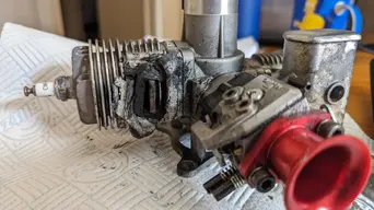

I used it to restore this 35cc twin.
This is what it looked like before...
