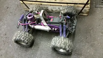

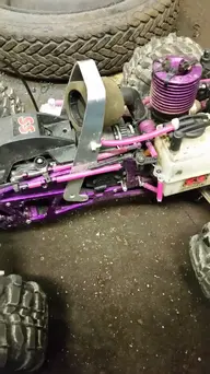

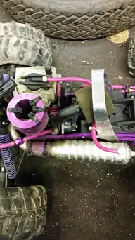

Post a few pics of your rig we can help ID it for you, then plug your rig into the link and download the correct manual, as there are several to choose from also have a look at the beginners guide and other tutorials to help you get started off on the right foot....
Here's the pics

I'm not 100% but looks like a savage x ss... Also looks like someone spent some cash on it with the upgrades..
Yeah they said it had lots of upgrades but I don't know..for some reason my controller won't turn the wheels now either..
Nope, the 25 radio box is a dead giveaway that it is much older. Assuming certain parts are stock, it is a Savage SS.
