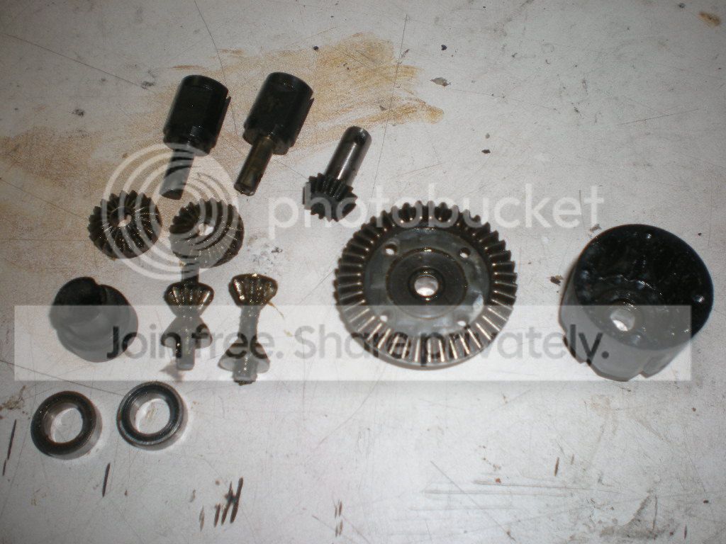

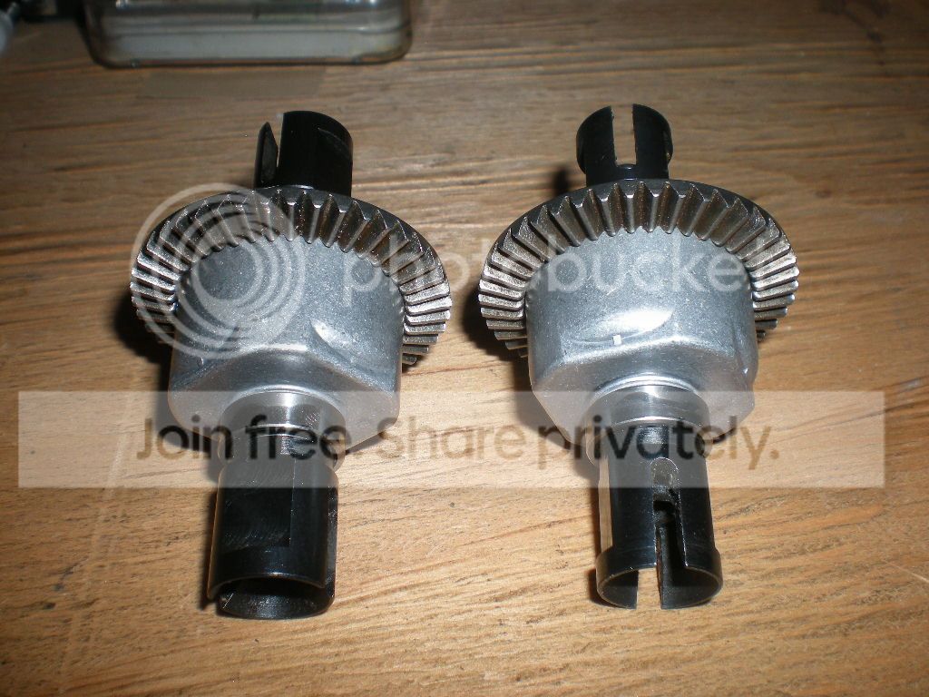

Where does the fluid in the diffs go? I took the bottom plate off and could see some diff gears but the lube was thick grease in there...
Look in the manual. There's a section about disassembling the diffs for maintenance.

I did already check the manual, it indicates using the same grease all over the diff unit (and the dogbone ends etc etc) - as I said when I took off the bottom plate there was a small amount of thick grease inside, not what I'd call oil - is that what you mean by "very thick fluid"??

You have to take the diff unit completely out and disassemble it. There are smaller gears inside the diff that let the wheels spin at different speeds. That's where you put the diff fluid.

Diff fluid still seems weird to me. I'm not new to RC but I am new to modern RCs I guess. In my day diffs just got silicon grease and you didn't worry about it again. And there were no center diffs, hehe.

It seems weird to me too, because the manual shows putting the same damn grease everywhere, and what is under the bottom plate around the main diff cog is definitely grease rather than fluid.
Maybe I'll just wing it.

Diff fluid goes INSIDE the differential to slow the action of the diff gears thus helping it to put power to all the wheels the same.. that grease you see is more for the ring gear and pinion gears.... personally I pack the inside of my diffs with heavy grease to attain mostly the same results with no leakage...
those are the differential cases removed from the bulkhead....
these are what is inside the differential so one wheel can turn independent of the other and where the diff oil goes for those who want to use it......
