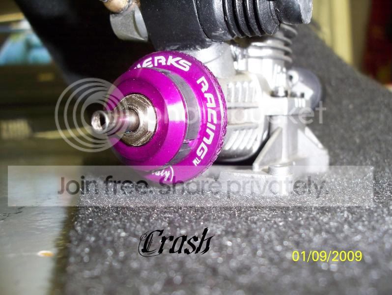

testing mine now

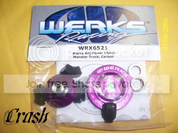

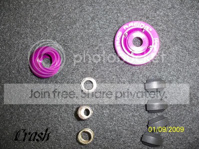

I have the Monster 4 shoe by Werks
I am testing now
using carbon shoes
you will need a adjustable motor mount to slide engine back slightly
Can't wait for the review Crash!

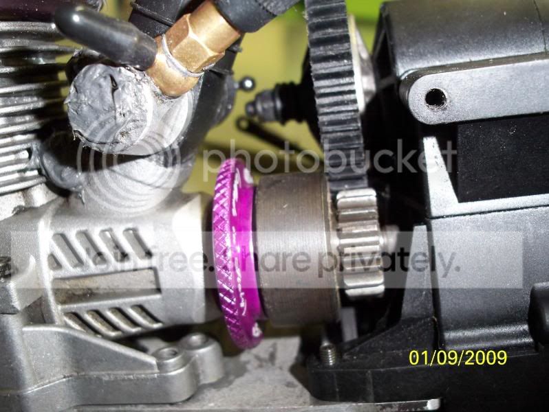

From the pics it looks like the clutch bell rubs up against the spur gear, (or is it just me). I want to use this clutch but i don't have any tools to make major modifications to anything made of metal (maby plastic, could use a file but would still be limited)
i believe thats what it looked like before he used the adj mount caz i can see a basic mount on that mill.

I just put it back in yesterday.
testing is in progress
here is a pic from today
