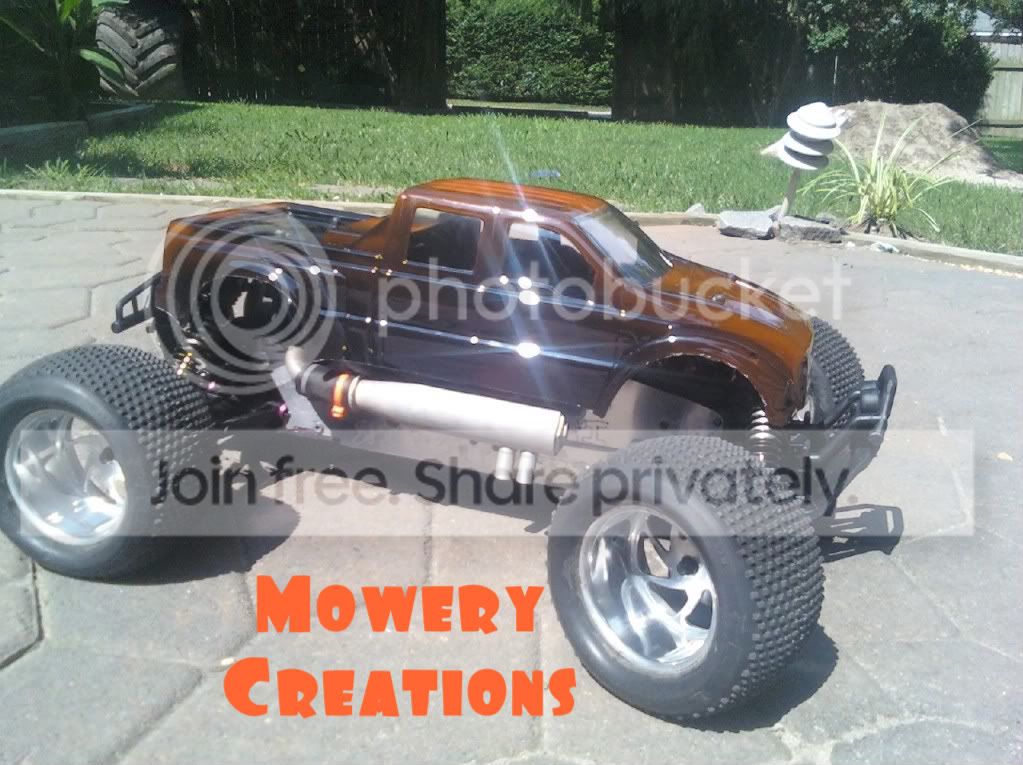

they are WAY better then any other wheels.They don't bend,strip.or break. They are made out of 6061-T6 Aluminum. you can get them 14mm or 17mm with the small hole or big hole.They have a 1 inch offset!! No more turning over when you go into a corner, You almost have to turn the truck over on purpose to roll it. Even if you were to bend one or strip it or break it, send it back and Spi will replace it for FREEE! I am a Spi team driver, I have been driving for Rick since April of 2008. I love the spi's. I have bashed them as well won with them several times. I have never bent a set. They are good rims for just about everything. Shelf queens,racing,bashing,pulling,Anything!. They go for 95$ for a complete set of 4, You will not ever have to worry about desroying another set of rims. All you have to do is get a set and bolt them on. No moding for them to fit or anything. They are defintly worth every penny.
Here are some pics of me hold some trophy's frm winning with spi's and some pics of my trucks.

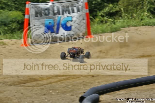

No limit rc world finals freestyle
