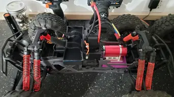

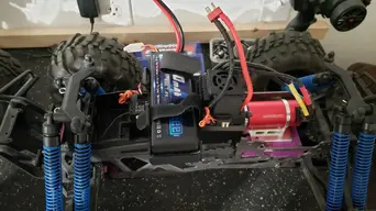

I just completed two electric conversions. I couldn't be more happier, and so are my neighbors! I can post pics in a bit.
Post it, lets see. I think I will do this one in electric. I am going to start building it in a few weeks after my fall rush at work is over. Doing some painting too that will take a month - think I will paint a body for one of these first.
The biggest expense besides the motor and esc was the center gearbox. You can convert it from a shifter to single speed but, I ordered mine complete and ready to drop in from RC4ME.US they have some one here on the forum. This one is especially nice because it includes a diff in it! It works great too. Let me know if you need some advice but mine were really easy to do.
Very interested. Great site. I just loolked and couldn't find the conversion, or at least what I saw looked like HPI transmissions. Can I get a photo near the spur to see the transmission and mount?
This is the integy kit. #c23712 $39.99 on amazon. The motor and esc were bought on Amazon Goolrc 120amp esc and 2650kv motor combo for 74.99. On the rc4me website search for savage electric conversion, it will give you a list. I picked what I wanted to change, the center diff w/gearbox, and a new metal spur gear. Total thru them was approximately 60.00.
