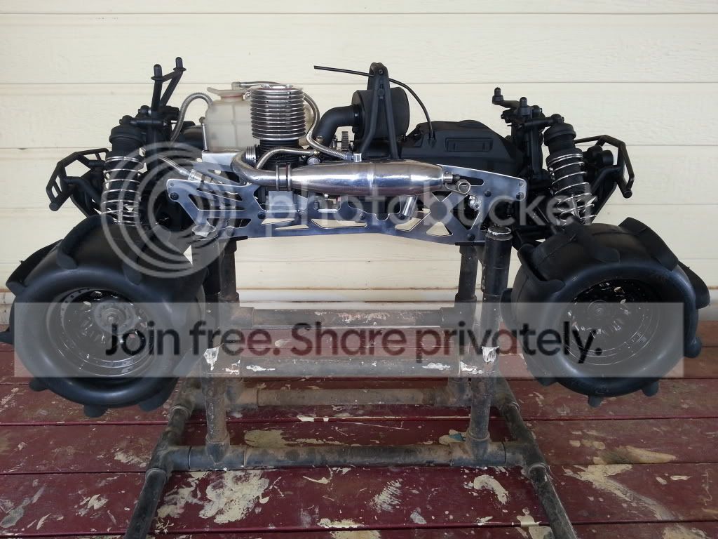

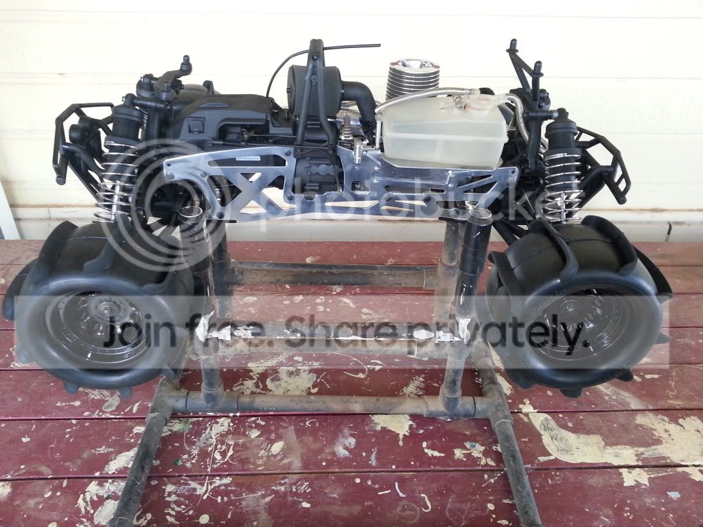

I started by deanodeanodized the orange parts and the tvps then polished them to and high lustre chrome. Added lst2 shocks. Front aluminum knuckles rear aluminum tie rod Eliminators did the cooling head to match. Chromed the clutch bell and spur gear.chromed my ths pipe.did my simple ofna 250 CC fuel tank location mod. Added the aluminum throttle and break mixer. Put on the rpm stable Max revolver wheels and panther paddle tires then wrapped it up with a new Jeep Rubicon body. Just simple but clean looking.
Nice Maximus. Is that a custom mount for the 250cc tank? You have some gravel pits or sand dunes near you? Would love to try paddles on my savage sometime.
Yeah I make the mounts for the tanks. Sits nice and tucked away from danger gets awesome run times and No more half tank lean issues ..utaall sand here in the desert .love running paddles. And the ones I use have such deep troughs they grip and flip some dirt. .love it.
Any chance you might make a write up on making that custom mount? I know I would appreciate it, also I'm sure alot on this site could benefit from this. This is a great in-between mod in case you don't want to go full mid-tank mod.
Yeah I already done one on it way back when I made my first mount. .and yeah it's a fast cheap way to do a mid tank for say. With out servo relocation and all that. Keeps it simple and stock with a nice tank and lean tank fix. .I'll try to locate the thread. .

Thank you. Oddly I remember that thread originally, or maybe just seeing that picture with the damaged stock tank. Is that 1/16th aluminum?
