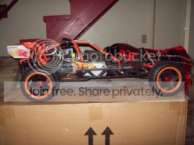

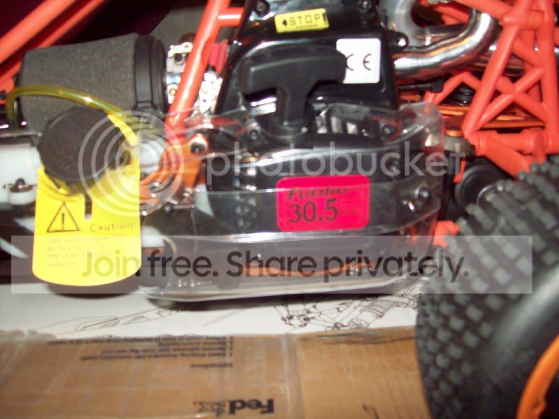

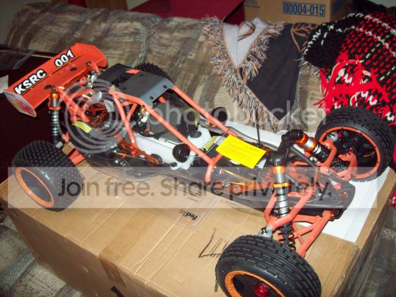

I bought a new KM Baja with a 30.5cc engine, here's a few pictures. Sorry for the bad quality on some, the sticker shows fuelie but who knows.
30.5cc should have some pretty strong low end. a decent pipe will up your HP for sure.
