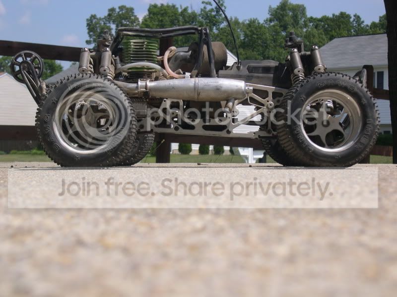

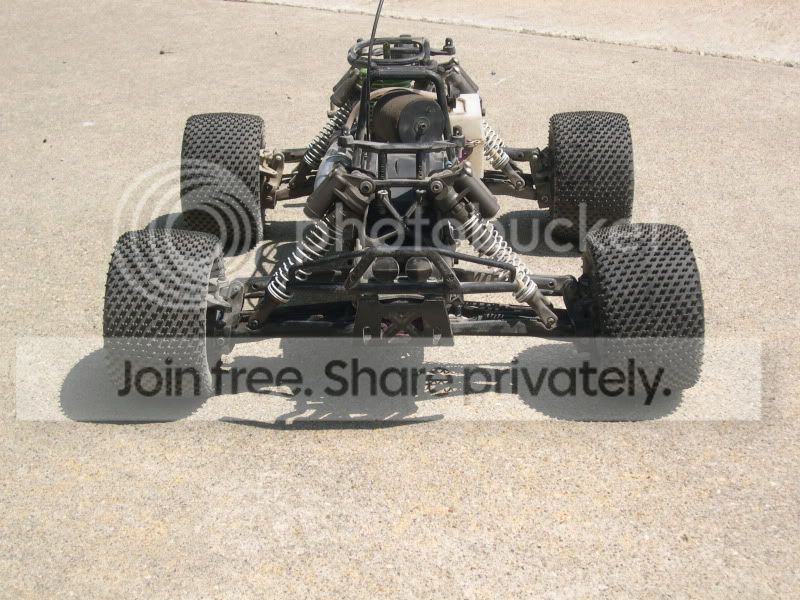

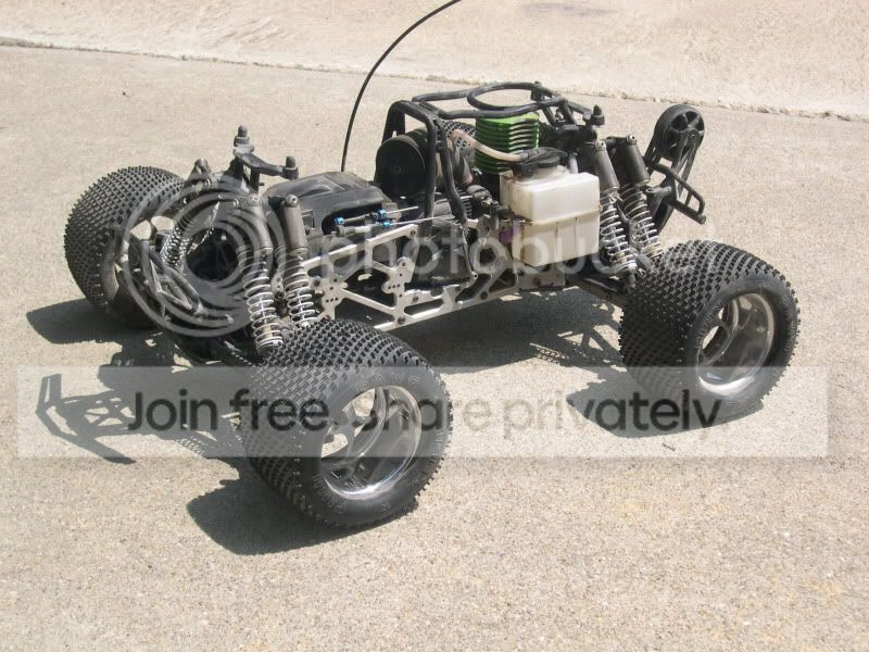

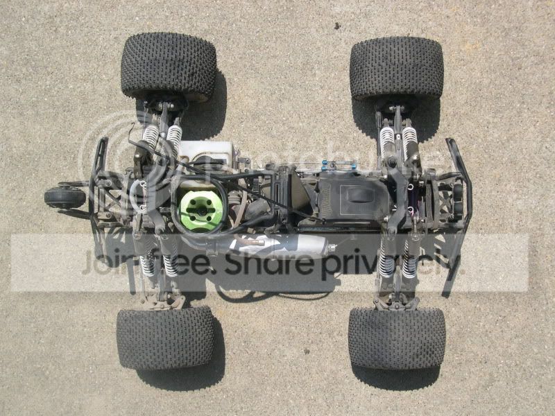

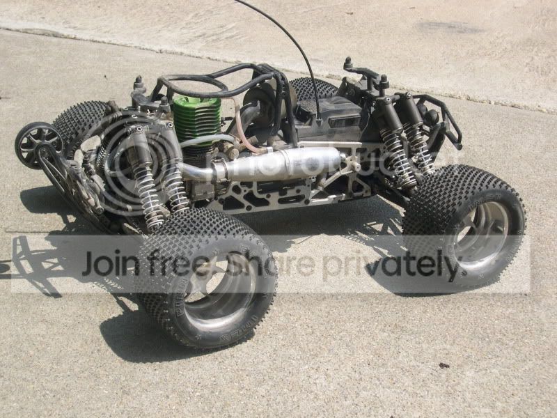

This is the ruck I built for my dad. He really likes it and shows his appreciation by beating the living hell out of the truck. Some of the parts include....
-FLM Chassis
-Axial .28 Spec 1
-8 CEN piggyback shocks
-New Era drive shafts
-SPI Aluminum rims/Pinn Dawgs
-OFNA Throttle mod
-SMF Screw Kit
-SMF Bearing Kit
Not too flashy but defiantly tough. I'm telling him he should let me do a mid-tank on his truck too. Am I right or am I right?

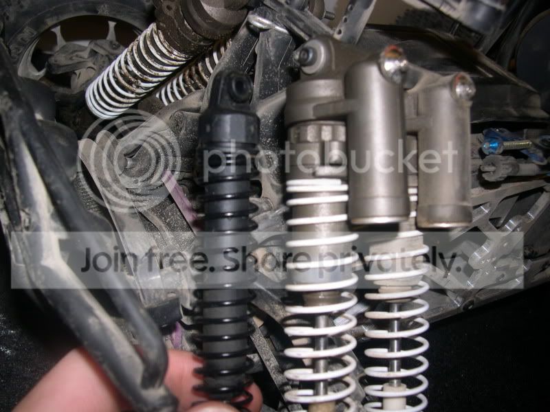

do the cen shocks bolt rite on?
Allmost. If you are using the X lower arms then you only need to shave off a small portion off where the shock mounts. If you are using the 25 lower arms then no modification in required. Cen shocks are tough as nails and lower the ride height of you truck a little.
