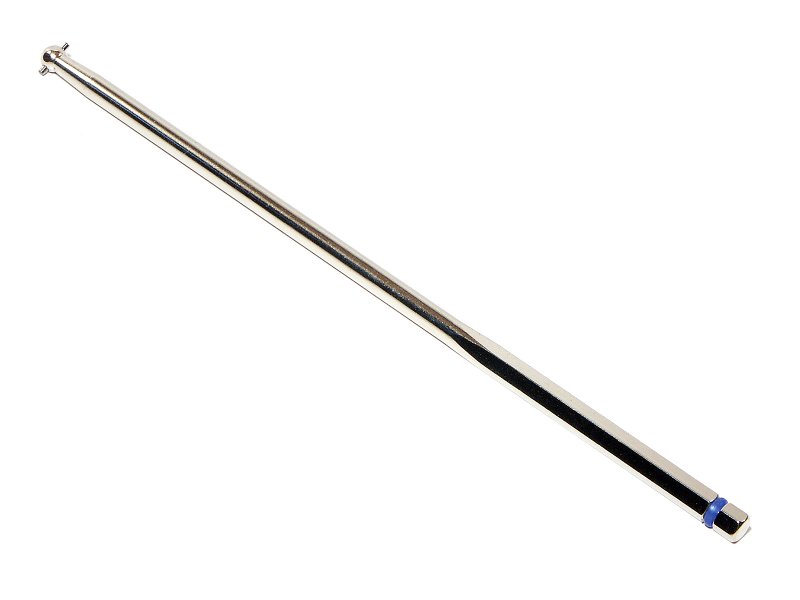

This 87617 vs 87116
I just gave mine away recently, well for shipping costs. The old engine, rotostart and shaft. I think it used the chrome one. It had a pin in the end.
If it were me, I'd huck it and get a pull-start. Or, I'd cut a slot in the sides of the cup with a dremel and find a dog bone that would fit in it.
Maybe the losi one would work?
https://www.amainhobbies.com/losi-spinstart-starter-shaft-losb5104/p5974

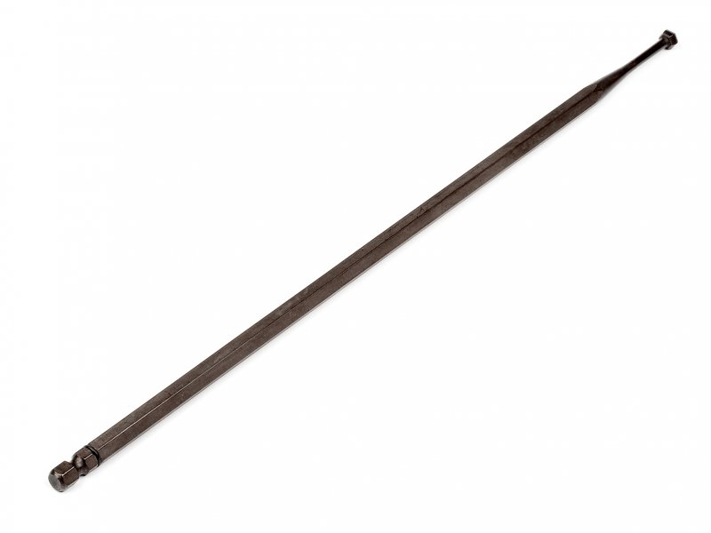

Here is one
By the way are you starting engine with a drill ? as they can over torque your OWB and damage the shaft if you don't "clutch" the drill down like the NITRO start dose. Try sanding shaft with oil and say 2000 grit wet/dry sand paper. just do the area where OWB rides ,stay away from the area where the shaft is in the bronze/brass bushing in the back plate.
https://www.ebay.com/p/HPI-15234-Starting-Shaft-NITRO-Star-K4-6/672824465
