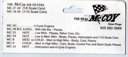

Order some McCoy MC8 plugs for it, I think an MC9 is gonna cause troubles for ya..... as for the fuel I never liked Blue Thunder much but it is better than Traxxas fuel to be sure.....
Thanks for the advice Jam Racing 1! Since I just placed the order this evening, I am going to call tomorrow and see if it’s not too late to switch to the 8s
Looks like they don’t stock the mc9. What about the mc59 or the os8 medium-hot?
MC59 is too hot and more of a small block plug, better bet is the #8 OS or an OS R5 in that case..
Hi Jam Racing 1
Just wanted to say thanks again for the very handy glow plug chart^^^
I was able to get the order changed in time to some OS 8 plugs.
