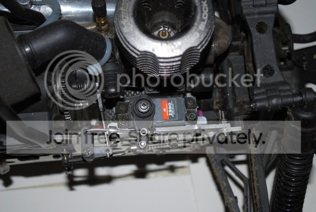

To mount a servo in the rear you need to add to the tvps not just drill... Ill get a pic of my stock tvped mid tank up. Need to take one. None in CPU ATM

For your steering servo you will have to mount the servo as Judge did in this link. The FLM TVPS has a mount point he didn't use. Sweet for this stock tvp question you posed....
https://www.hpisavageforum.com/forums/showpost.php?p=58186&postcount=22
As for the throttle Ill get you pics up on this post. Ill see about tonight. I also have a vid I made for jester to answer these questions too.
Note: I'm not a hack. This is my basher and its all spare parts This was a mock up I just ran instead of finishing. I only had to buy one diff to build this out of a box of parts. then added that mill...
But Ill take all the comments in stride. (If the hardware does not bother you you may be a hack...)
Blue box is the added plate. Red screws retain the plate. Green retain the servo mounts Judge posted below

I'm starting a mid tank just like judge's but I ran into a BIG snag very early! THe servo plate doesn't sit straight on the stock TVP's U can drill the side of the TVP's to get it to fit BUT....... once u have that done the trany case presses up on the servo plate so my pic's. Any Idea's?
As u can see the picture above I will need to drill inbetween the top hole and the bottom hole But.. the trany is in the way see the next pic's any Ideas?
here are better pictures with white dots where I was going to drill I cant get it to the hole under the white dot because the bracket wont reach. I'm sooo glad its winter and no down time! Cheers!
chop cut rebuild.
i would get a marker out and see how much you actually would have to trim to make it fit. i think the reason it works in the flm tvp's si cus the trans is dropped down for the LCG.
