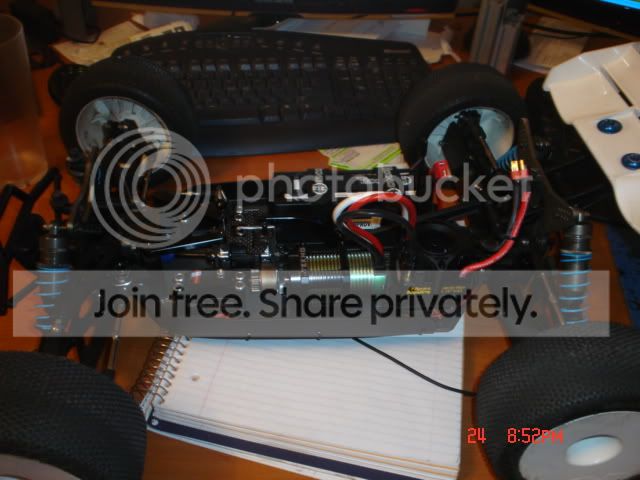

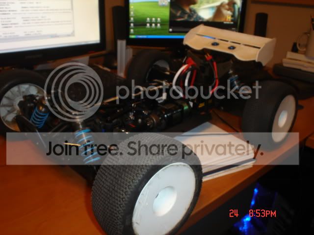

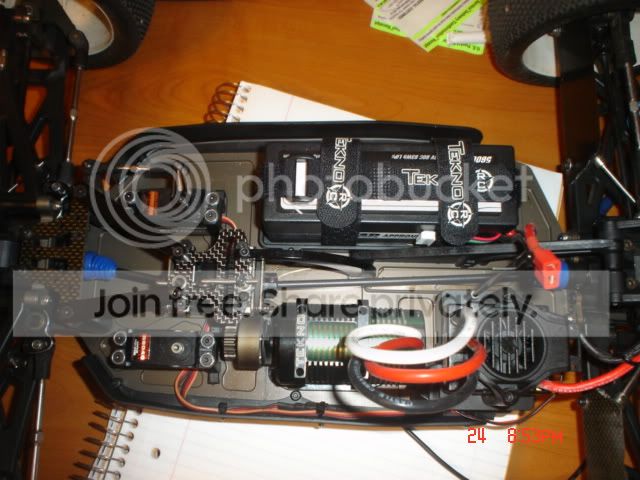

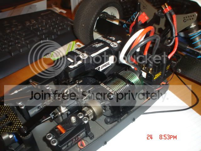

I just pretty much finished up my BL conversion on my Jammin X2 CRT. I took it out today for its mayden voyage and WOW!!!!!!! I am running a Mamba Monster with 2200Kv motor. I have not hooked up the mechanical brakes yet, I have to figure out the mixing on my radio to do so. I also am running just 4S right now with a 17 tooth spur. My front tires balloon like crazy but the thing pulls wheelies, lol.
I have some minor tweeking to do, but for the most part its done. Here are some pictures

Right now I hate it. I know the concept of why it is there but there is to much slippage and i have metal clutch shaving all over the truck. I made the desiscion to pull it and run the motor straight. I am waiting for my pinion gears to arrive, I orderd them yesturday. Oh almost forgot, the clutch itself was so hot yesturday you couldn't touch it.
