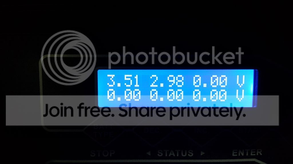

Any how, I connect the battery (5450 mAh 2S 60C ) to the battery checker and get this:
My understanding is the cutoff is either 3V or 3.2V
How did my car let the voltage to go to 2.98V???

I'm not worrying about the battery unneccesarily. Just wondered why a cell went to 2.98 when the Savage's LVC should have stopped it at 3.2
Now , I think, the reason is the savage sees 3.2 total ?

Still, I'm uneasy about the vehicle's LVC and the voltage per cell.
If the Savage Flux HP is set to cut off at 3.2, whos 3.2 is it?
First of all, there are four potential 3.2's because two batteries and 2 cells per battery.
So , what does the LVC monitor?
