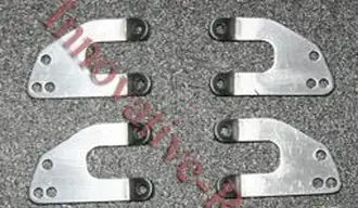

These are the blocks for the Savage X lower arms:
These Brackets are used on the early Non X arms, HPI #85047 the ones with the shock fixing hole on both sides of the lower arm. With the 2 holes on the small bent section locating with the 2 holes either side of the arm where the original shock would mount and the 3 holes in the other end being 3 different mounting points for the LST shocks to relocate to.
