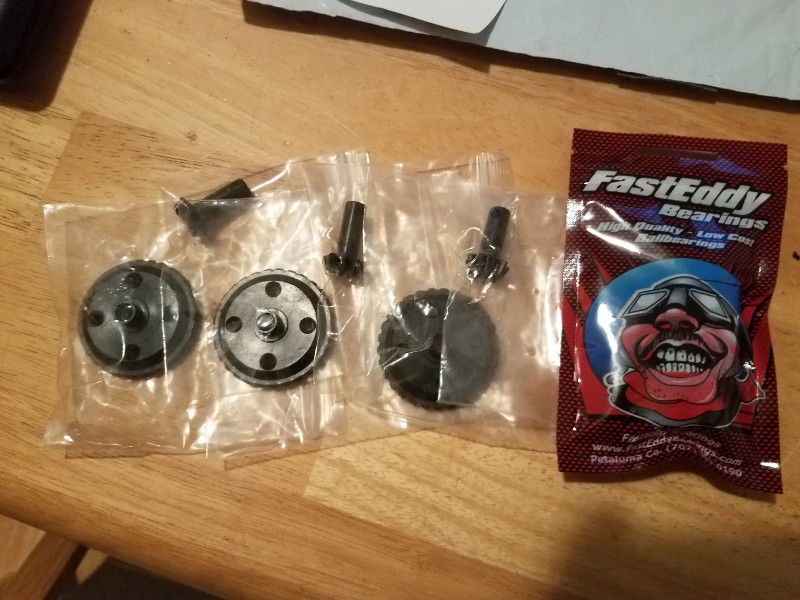

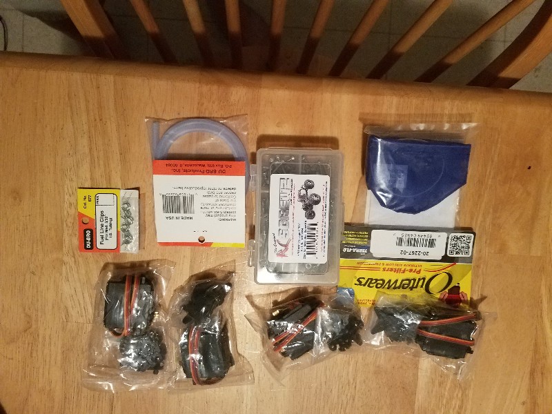

So I've got a few of the parts in for my Savage X rebuild, been down for over a year with bad diffs. And I'm already getting the itch to run it already!
Still have a bit to go before it's running, que the waiting for ups truck memes lol

More arrived today, wonder how long before wife is sick of the packages? Got about a dozen more arriving sometime lmao!

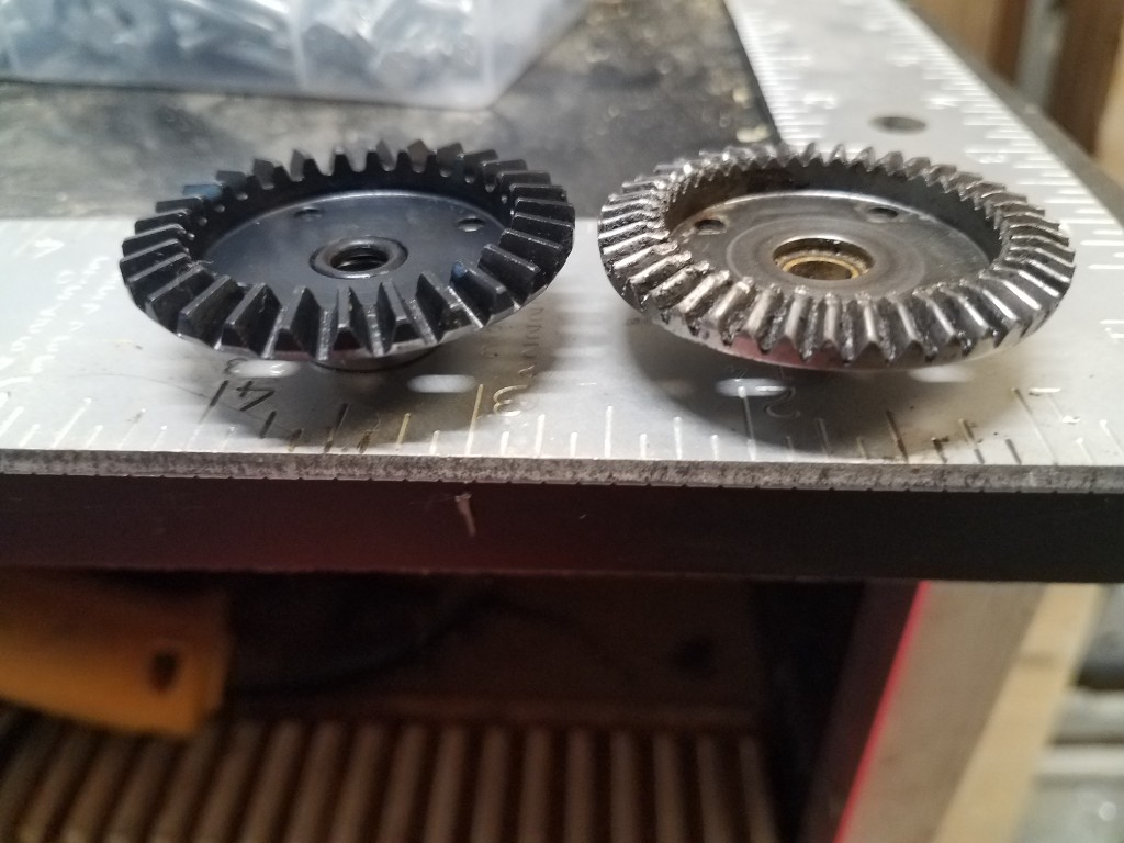

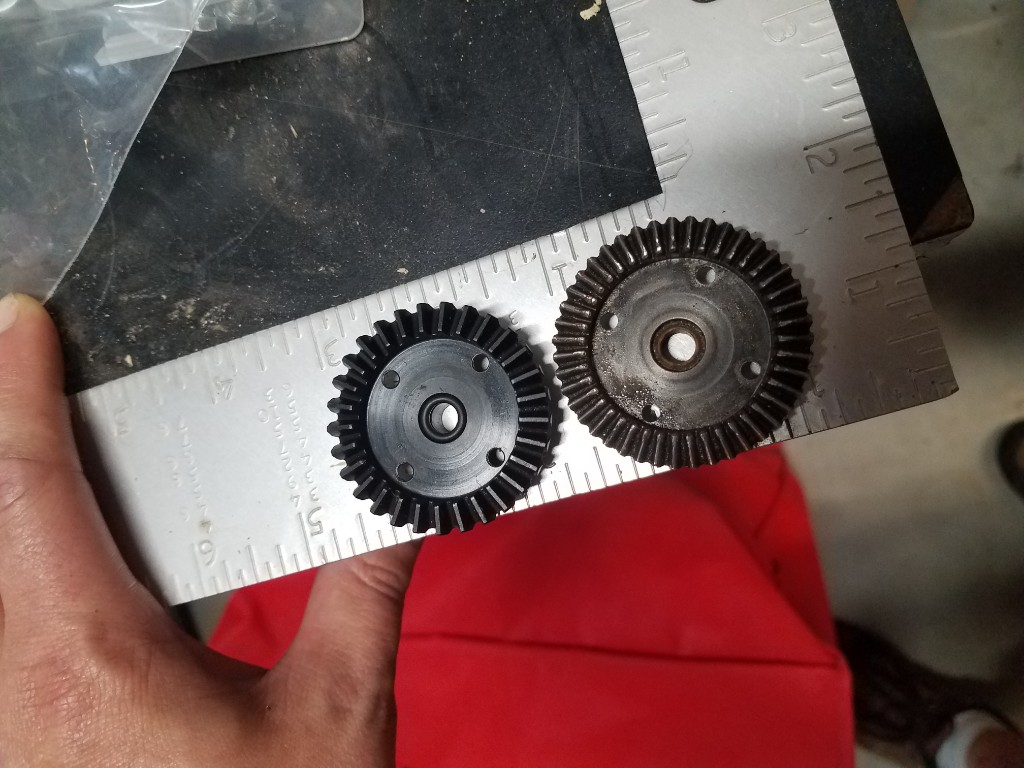

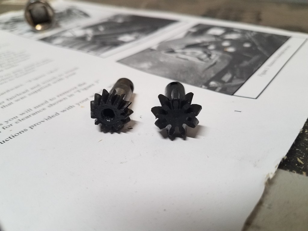

Just little update, the itch is getting worse! Lol still waiting on some things but got started on rebuild. Seeing the rc4me diff gears next to the stock ones make me feel pretty good about them. I'll upload a side be side when I work on it next. Ordered fuel and never received any info (been 11 days) so sent email and apparently my order never made it to shipping dept... should be here it before the savage is ready to run anyway

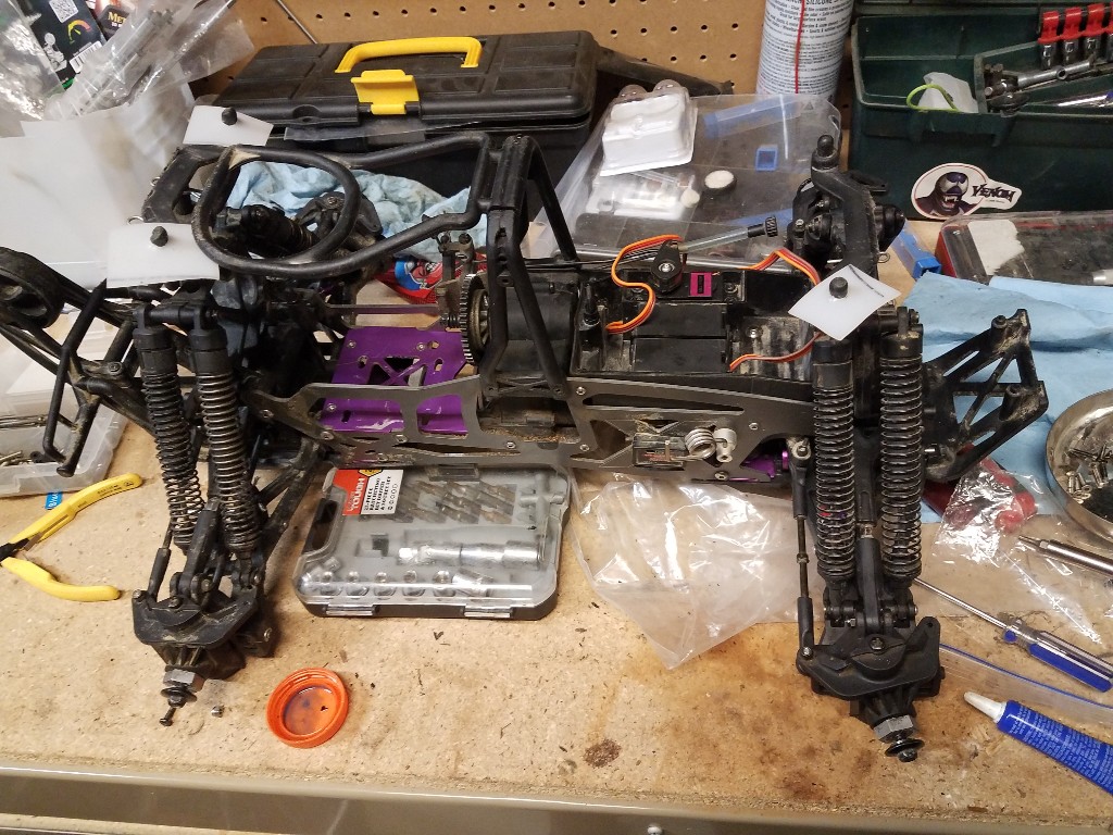

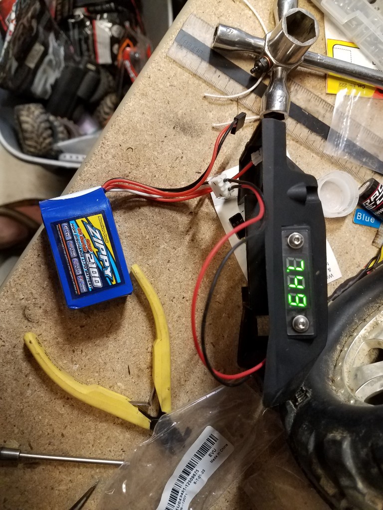

All that I have done so far is replaced bearing in all but engine and trans, replaced diffs ring and pinion, cleaned and rebuilt diffs, installed swaybars, and replaced most of the hardware with stainless, installed new throttle servo, trimmed radio box lid for battery and voltage display.

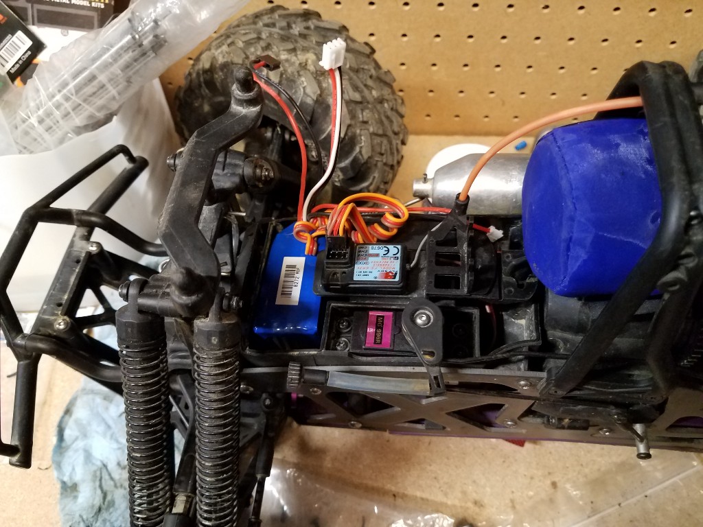

I got it running a little today, got to figure out the tune some. As I was trying to dial in the tune and having to restart the one way bearing started slipping. Heres is my electronic setup, running UBEC in the space at back of radio box. I did have a slight hiccup as the new throttle servo decided to go hay wire, but I got a backups.
Modified the lid to clear the LiPo pack and for voltage display.
Now waiting for the one way bearings I ordered to arrive.
