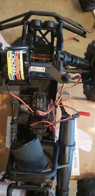

Hey guys I went out and got a hump pack , I disconnected wire from old 4 cell battery holder and figured I connect new hump pack to the wire that I disconnected 4 cell from the wire that goes into the off side of the power switch but of course new hump pack wire and that one don't fit together...so I connected hump pack wire into servo where the wire from the side of the on switch use to go still wont work what gives ?20190602_160301.webp
Yep its fully charged , I did some research. I had to buy a new start switch which has 3 wires and right connections for hump pack all good now.
You could have just cut the 3 lead plug down to a 2 lead and jammed it in the JXT (red 2 lead) plug. That's what I usually do.
It's never a bad thing to have a spare switch. They get dirty and glitchy over time. I always keep a few in my parts drawer.
