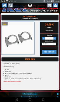

The motor clamps is the same as flux hp I think! Alza racing making motor clamps in different size to fitt many can size. motor-mount.jpgScreenshot_2018-09-26-22-06-18.jpeg
