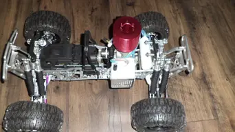

Guy's Here's my custom built Savage just about finished. You see I've been working on it for about 1 year (It's 2.5 inches longer that a savage 5.9)... But now I'll have to look for a body that fits (Octane body is a bit small), so can anyone recommend one that's a bit longer... Oh, one last thing that since the fuel tank is small... I plan on fitting a heli header tank and the back of the truck.. That way the truck will have longer run times. (Picture will come when fitted).. I just hope that I can get the hex starter wand in there.. Because the header tank is longer than the other ones...

Nice build and man, that motor is huge. As for bodies, I'm usin IRC (Innovative RC) 1" rear + 6mm front extended TVPs and 10th scale short course bodies (HPI blitz) fit pretty good. And they are a bit wider too than stock savage bodies.
Maybe check the specs on the CEN genesis body, or the LST XXL. Guessing those are pretty long.
I found an LST2 body in my closet that I forgot about. Makes my savage X body look like a stampede. lol
Thanks for the info guys on the bodys (I'll check them all out.. and yes.. You should see the motor.. It looks very impressive in my Savage... Though can't fit the Savage 5.9 roll cage to protect the head, as it don't fit.... Because the head is too high...

I don't think that my Savage will have too much power from the motor.. Remember the Truck that the motor was designed for was the old Thunder Tiger EK4.. Which is a smaller MT and lighter than mine too.. Also it wheeled all the time too (From all that power), and single speed too, as for a body... I just bought is a MGT 8.0 one, and with shipping only cost me $37.00 (Though I hope that it's a big longer than the Octane body). Plus that truck has a gasser 15cc motor and it's the same length as other savages. Mine is 2.5 inches longer, so the 11.5cc nitro motor will be fine in my extended Savage...Though I'm not sure which motor has more power.. The HPI 15cc Gasser motor, or my Thunder Tiger .70 (11.5cc) Nitro motor...
Oh, you know what they say.. The bigger the motor the better the truck HEH!!!

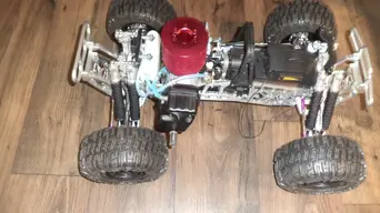

Here's the Truck Guys.. Just waiting for the header tank , and that MGT 8.0 Body to arrive.. But the build is finished.. Phew!!!... Don't you all think that the motor is prefect in the truck eh? (The Truck is way bigger than the pics show)....You know what.. I would say it's now a 1/6 scale truck...
Oh, the starter is the HPI one, and I replaced the wring to 14swg (Was 16swg). Plus I fitted a Torque Master 550 motor (Ball Raced), and the battery for the starter, is a 11.1v 4000mAh 3-cell LiPo...

That's a weird exhaust for a nitro truck. The engine and head looks crazy big in there even though it's stretched!
Yep, the finned exhaust adapter is from a HPI Octane (Fitted perfectly.. Though it was very hard to find) , and the box muffler is from a HPI baja 5b.. You see.. The engine is a side exhaust one, so this is the only way to fit a muffler to it (Both can be fitted to the Octane too), and the large nitro engine looks just right in there for my stretched Savage... But you know what.. I'll have to run at least 10 Tanks of heli or plane fuel through it before it's fully broken in (Ringed engine)....
