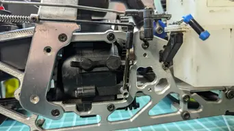

Aluminium clutch shoes require frequent maintenance and develop a lot of heat. This necessitates more bearing changes.
A better choice for the Savage would be a slider clutch system with composite shoes:
This setup has much more clutch shoe surface area and won't kill your bearings - because even when it's being thrashed around, it doesn't seem to get hot.

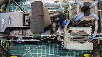

Linkages have to be set up just right. This is how I run mine.
Check your radio's end points and observe the operation of your throttle and brake linkages before you attempt to start the engine next time, else you might end up with a run away - that's no joke with a 12lb truck.

I WOULD LOOK FOR THE RETURN SPRING FOR THE CARB SLIDE.
YOU CAN SEE IT IN THE OVERHEAD PIC HORATIO SENT,
IT GOES FROM THE HIGH SPEED NEEDLE/FUEL INLET TO THE
THROTLE LINKAGE BALL.
