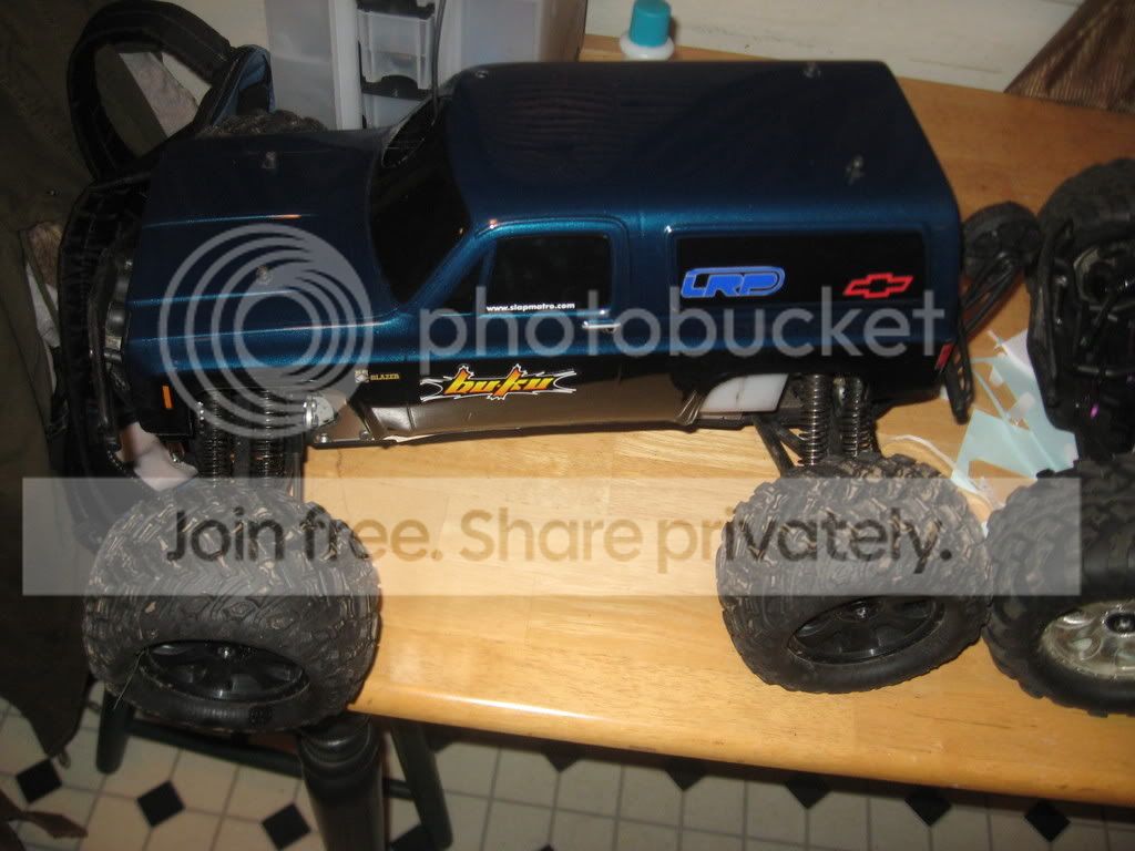

Shot of tires/wheels on my savage:
First time out:
The conditions were 70 degrees, lots of wind and the ground still a bit wet from rain the previous day. I took several high speed passes watching the flex of the wheels and noticed that they did not balloon out very much at high RPM. On the other hand in turns the tires moved inward towards the TVPs instead of staying centered above the wheels. This is something that most likely can be solved by getting better foam inserts. The truck was driven both on grass/dirt and pavement and the grip was great on both. No issue hooking up for wheelies at all! I also found another small side effect of having grippier tires, I had to tone down my brakes some. Since the grip was better, the truck was having an easier time digging in when I hit the brakes. The savage was driven for a couple hours at high speed and low and over many jumps. In the end the only issue I had was that one of the tires was coming off partially from the rim, just glued it back on.
