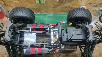

Hi, I have three different converted Savages. A Savage 21, an Octane and one with purple XL TVPs.
I had to drill the holes for the battery trays. I made my own motor mount adadpters but this is not easy (better look for some already designed type available for your rig).
The remaining modifications are easy.
I attach some pictures of the purple XL type. which is the most similar to yours.
The servo close to the motor is for steering the back wheels. I also use a longer slipper shaft (from 5SC) to be able to fit a twin slipper clutch. and 43t spur. These are additional mods that I did but are not required.

Thanks both (loving the pics orzo!) but, plot twist.. a new Flux XL complete centre section inc TVPs batt boxes transmission etc turned up on eBay for a good price so I hit the button & bought that. Reasons include; I've a lot of RC projects already underway so I can't devote so much time to experimenting & learning by my mistakes, I'm getting a lot of parts for the money, I want a lively MT to hoon about with not the ultimate Savage, and upgrading the bits that break will be straightforward. Plus the wife was out and I had a big shiny button in front of me :oops:
Of course I'll still need a motor & ESC.. Is the stock setup a re-branded one available cheaper elsewhere under a different name?
Well done. The nitro XL comes with sintered pinion and diff gear. You will have to change those to the forged type when they wear out.
The stock esc is a rebranded 150A hobbywing QUICRUN-WP-8BL150. You can also use the EZRUN Max8 V3 150A if you want to have extreme punch. Both can handle 6S.
The Tork 2200KV motor is quite unique but you can use any other 4274 size 2200KV motor (better if the motor can outside is flat at the edges without bulks that could interfere with the mounting brackets). Check that the motor shaft length is long enough (I had some problems with this in some of my conversions).
Enjoy the assembling
