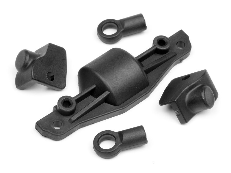

I tried zip ties but unsure in a crash if that would still prevent (as the bumper seems to move quite a bit when it hits head on). Glad it's working for you though...I just don't want to lose any pieces. ;-) In the event it does not work out long-term for you I did a little research and it looks like #102520 it comes with parts that look eerily like what I made to capture the rods so they hold up in all scenarios. I found them for as low as $4.00 online. The other pieces seem to be for mounting an anti-roll bar. You;d think they would supply these with the kit itself, but I guess learning how to prevent these issues is part of the fun.
Very good to know! If the ty-wraps don't hold i'll be definately trying this option.
