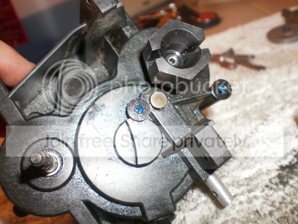

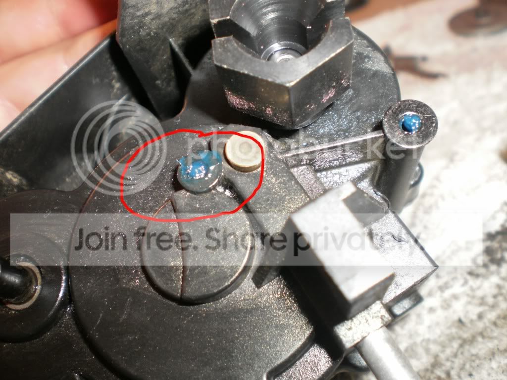

Ok so I was putting the red fiber brakes on my SS and kept sliding the washer off every time I moved the tranny... Then I remembered what I used to do when I was a mechanic full time, use a dab of grease!
then place the washer on top...
And that will hold it on till the screw is through it.
I didnt see this tip on here, I probably missed it, but here ya go!
