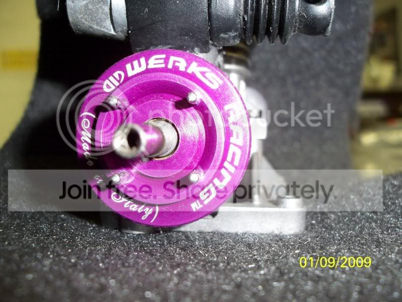

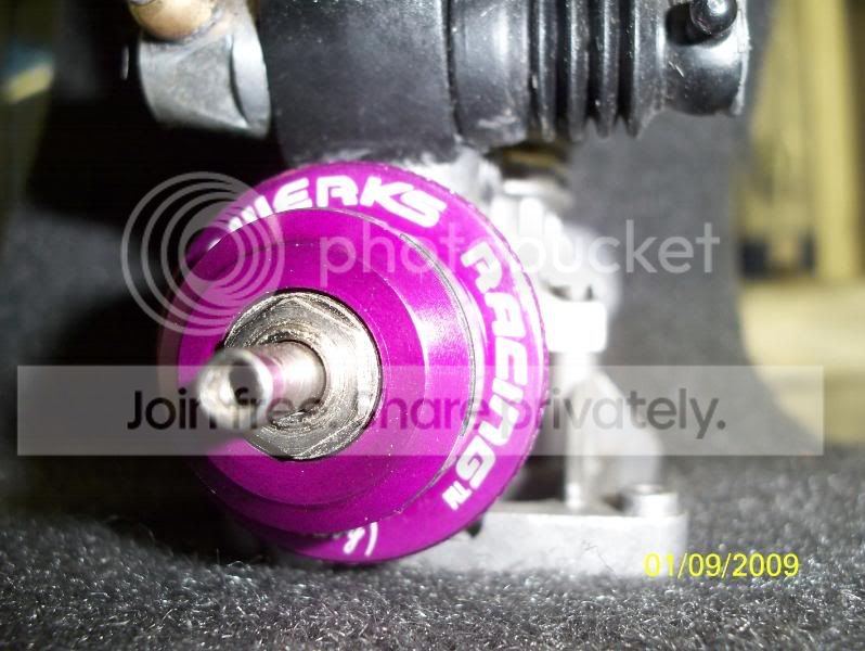

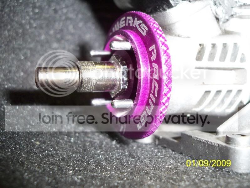

here are some pics:
so instead of loosening and falling out it'll tighten and mess up the set adjustment? hehe
I also thought of that and was going to put it in that post but I'm sure well I'm not sure but... if its on the market it works. how ever its done.
I wish John would step in to clarify this ( the install the engagement the wear ) over all performance of the Werks clutch.
Werks clutch is good. there is an o ring on it to keep it from getting tight and locking the clutches in engagement. You need a deeper clutch bell like the titanium ones from racers edge. the stock savage bells are 14mm and the shoes hang out the back. were is very good with almost 100% of the shoe touching the bell. I still put HPI loctite on it for extra protection but have had it on 4 engines with out an engagement issue. Right now it's on Brian's Novarossi .28 and works like a champ.

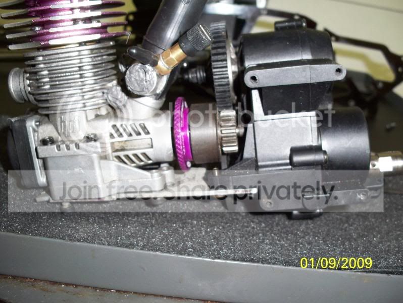

Very interesting, Great pictures. You will have to do a Review on them as you get a little run time on them.
By the way what gearing are you running they look pretty high(19/47?), are you going for speed?
thats not the bell that I will use
It doesnt fit with this clutch
I will start with 18/47
I need to find the proper bell, it doesnt cover the shoes and rubs on
the spur gear.
I am looking now for a bell.
Can you please post us some fresh pictures when your get the correct bell so we can see the difference between the to and how well it fits once received?
in actualality you still have to remove engine to adjust the clutch.
here it is, instalation was really easy. Much easier then your standard
3 shoe clutch.
need a diferent clutch bell as John said.
