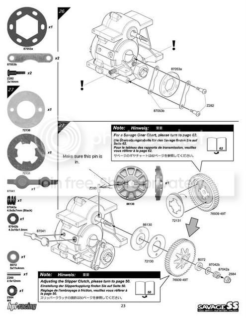

or is it possble a drive pin is out of the truck somewhere?
Ck and see that the pin marked is in there.

http://img.photobucket.com/albums/v214/dhaxt255/Pin.jpg
k i pulled the spur apart and all the drive pins are there..
