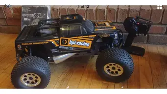

This is the Octane I just picked up. Has 2.5 gallons of GAS thru it 🙂 (per previous owner) Cant wait to get it out. Just gotta love the weather we've been having in the midwest here... Will report on how it runs. Post a vid if I can.
I am looking foward to running my octane but in the same sense a lil scared cuz of all the horror stories I have checked the Hsn and lsn and have put them to stock setting per a few posts I have read for stock settings I have read up a lot on the beast and hope I have a good one if not I won’t give up till it’s crankin wheelies lol...sounds and looks like yas all have nice collections I kinda put my buying on hold due to gettin a 2019 Honda Grom which I will be able to play on to and from work but after that it’s gonna b all bout my mt’s I have two nitro monster Kings a hpi bullet mt a Savage 21 and a octane xl and the only one I have ran since getting into hobby late last summer is the bullet so all the other will need tuned and the 21 n octane will need broke in due to like new condition with only start up ran in them I did lube the cyl. so they wouldn’t rust on me can’t wait for warm weather sorry for long post been awhile since my last post...589FC160-9F6F-4411-A709-D66862DB20BF.webpCAB24108-9430-4267-B54B-A4376889BE91.webp589FC160-9F6F-4411-A709-D66862DB20BF.webpCAB24108-9430-4267-B54B-A4376889BE91.webp3ABCDA28-8C68-429E-AD9D-D0D94EC5799C.webp
Sweeet .21 you got there, BTW. Weather here in Wisconsin has been miserable, but really prioritizing my Octanes when I get going. I want to look into the rear tracks for snow running in the winter, either with skis or tracks in front, depending on what I can find. Integy's key hub parts for the tracks are MIA....Even thinking of getting a small milling machine to try to make my own. If anyone out there has a set of tracks and has used them, I'm more than interested in hearing more about how well they work. Meanwhile, I'm still slowly assembling my .21. I'll post some pics on the other .21 thread. Seeing these pics gives me spring fever, good luck to all..!!
Thanks buddy....any pointers for me when I do break out the octane this spring any would be greatly appreciated also what other forum is there for.21 you’re talkin about??? Like I have said I am a newbie but a very good motorcycle tech which is my day job and has been for bout 10+ yrs I have been around 2strokes so I know a bit about them just the octane has me a lil gun shy due to the horror stories lol...can’t wait to see your pics my .21 has only been started twice I got it from a guy who has a pile of nitros and it was a shelf queen but that is changein this spring lol
Is your octane brand new? Yes there has been mostly pain-in-the-@$$ stories about breaking in the Octane engine, but beyond that they run like a beast after like 20 tanks....there are also cases where the engine has started/run great out of the box, tough to say what the difference is. Make sure your batterys are topped off, the ignition is sensitive to low voltage. (Li-Po upgrades are common) Looking at some of the videos, it seems like they have problems getting fuel, like maybe pressing the primer a bit after its started may help. The Walbro carb is VERY sensitive to adjustments, as the threads on the screws are very coarse, so 1/24th turn adjustments are best. A common trick is to move the ignition out of the radio box to right behind the fuel tank to get it away from the batteries & receiver, but you will want to do something to keep it dry. Be patient!! I've heard a lot of depressing stories of guys giving up too soon on this awesome piece of RC history. The reward with this truck is WELL worth the effort. There is another thread on THIS forum discussing the original Savage .21 that I was active with; your choice rig fits right in. Your experience with two-strokes should give you a leg-up with the Octane, these are kinda like tiny weed-eater engines. I used to race motocross back in the 80's, so that helps me some...let us know about your experiences when you get motoring!!!
It’s looks brand new the people I got her from found her in a storage shed along with some electric rc vehicles they tried to start it but the fuel they showed me they used was something already premixed they said it started up and ran like few seconds then shut off and the batts weren’t full charged so that also was a issue I think, I checked the hsn n the lsn and they spot on factory settings and the piston and exhaust look brand new with no carbon build up like a 2stroke normally would have I will def keep my progress posted and will not give up till she is crankin wheelies lol thanks for all ur info and help will def be lookin for more advise if problems arise n are beyond my knowledge or the fm factor lol
