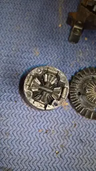

WP_20160926_20_11_23_Rich.jpg I inspected my differential a little closer tonight. Hmmm, I don't think I'll be reusing the spider gears. The one is chewed up pretty bad. Now I have to decide if I want to build a differential from scratch by using HPI 86827 & 86032, or lock it with Hot Racing's locker. I can't really find any reviews on the locker though. Any thoughts?
I wouldnt use any of those gears again actually, looks like it was not lubed and grit and all built up causing the diff cup to break.... build it all new and pack the differential with heavy grease, red hi temp stuff works well....
This was the first time I had the rear diff/bulkhead disassembled. Three of the four screw caps were snapped off that hold the differential together. It was really gritty, although now metal 'chips'. I'm not sure in what order things went bad, but there were quite a few things that were not right.

But what you showed us in the pic aren't the same.
Seriously? How can you tell? Like I said before, I never had this particular one apart before, but I don't know what the previous owner did.
Regardless, I will be replacing all the gears and will be using #102692 BP gear, #86827 housing and #87193 internal gears. Hopefully that fixes it up.
Hmmm.. After looking at the pic on a bigger screen you do have the BP gear...
But I think they are the sintered and not the machined. Machined are a lot stronger.. Machined are black and sintered metal color..
