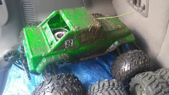

Here's a minute of mucking. I was holding the phone so a minute was good. Ran it through a tank and got nice and muddy.
This came with a new reverse module which I should figure out how to install.
" I don't understand why anyone wants glow power with all the fuss "
" Was a blast! "
NOW YOU'RE HOOKED
I have the 87032 Reverse Module Install Instructions ( without mixer ) if you need it.
