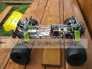

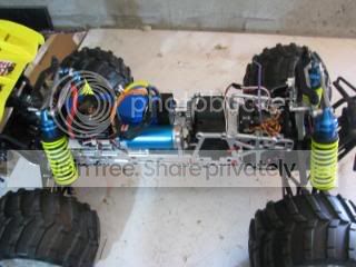

First post here. Figured I would post up what I have done to the Savvy.
Flm Savage chassis
Medusa 36-80 1600kv motor
HW 150a ESC
Zippy 5000mah 6s LiPo's x 2
icharger 106b LiPo charger
New Era Wing mount
New Era 23mm ext hubs
New Era Shock towers
New Era Wheelie bar
LST Shocks
IRC Shock mounts
Airtronics MX-3FG TX/RX
Rear tie rod eliminators and adjustable upper a-arms
23mm wheels and tires
Wing

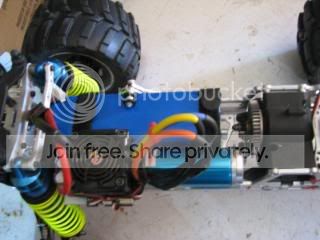

Just have to mount the esc and motor tonight and almost ready to go.

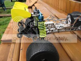

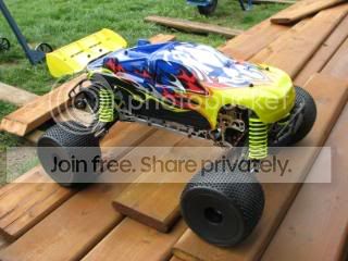

Here is some final pics of the truck. Was able to get two packs through it then the motor shaft snapped off and chewed my spur and pinion:duh:
Time to start looking for more parts.....
Bummer deal! Thats some great power though. Awesome looking truck and welcome to the forum.
