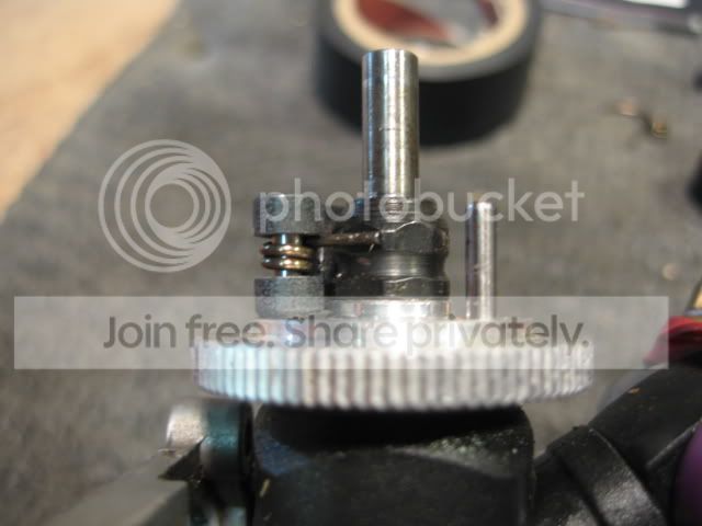

One more question, thought i would save you guys a break from moving to another thread. I picked up the Dynamite max lifes and Mugen 1.0's, on Wednesday and went to install them and ran into this problem ::
That is the stock savage x pilot nut. Shane (redneck) said shim the nut a bit so the spring will sit on the groove. Any other ideas ?

Brandon, as far as the fuel goes, you should be fine. 25% is the percentage of nitro, not oil. You get a little bit more power out of the mill switchin to 30% from 25%. It's the oil percentage that you wanna watch. I'm runnin Byron's Gen2 Race 3000. Which is 30% nitromethane and 11% oil. With the clutch spring problem, just push the end down into the groove and you should be fine. I've had to do that in the past and never had a problem. Or, just end up switchin out the stock pilot nut for the mugen pilot nut.

like jr said, just push the spring end down with a small screwdriver or somethin'.
ps the mugen pilot nut sucks. you think your havin' trouble with the hpi nut, try the mugen.
It's funny you say the mugen sucks because lots of people recommend that nut but personally I run stock on both my savys and never had a problem with the same setup posted but i guess people just repeat what other people say and don't even have experience with it.
