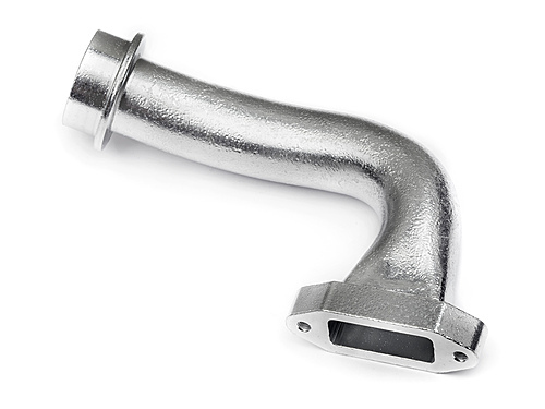

Mine has a gap also. I have seen pictures of Octanes where the manifold has bent pushing the exhaust up against the side of the truck.
This is a picture of mine showing the gap between the exhaust and the roll cage clip
Ok, perhaps mine has got bent as well then, however that happened. I guess when the exhaust has been really hot then.
Thanks for the photo Paul!
I'll see if I can bend mine out a bit, to give enough gap to insert/remove the clip.
your manifold should have a nice gentle curve like this
