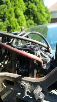

Here are some pics of what it looks like. Is it truly worth replacing or just going out and buying a whole new unit. The damage looks a bit extensive. Can it even be repaired?

Definitely melted the whole ESC package. My guess is that the PCB inside didn't fair well either. I would say it is definitely in your best interest to buy a new ESC/ motor combo.
Wow! Is the motor still ok? Looks like just the ESC blew up.
If the motor tests ok with another good ESC I would recommend getting a stock replacement ESC because it fits so perfectly in the frame rails.
Also, one thing I appreciate about the savage XS is that it really doesn't need any upgrades in the power plant department... It's quite overpowered.
I wonder if your cooling fan failed and aided in the meltdown...
