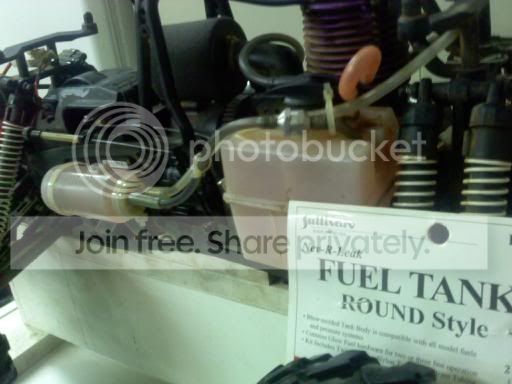

I got tired of filling my tank every few minutes to keep from leaning me out. I used a Sullivan round style tank (# 401) and mounted that as a ballast tank. It ran great and fixed the MTL. I notched my radio box so I could fit a zip ties through. I used shoe goo to stick it onto the tvp. This cost me less than $6, so this is in my opinion is the cheapest and easiest way to solve MTL and you don't need to sacrifice tank size. Here's what it looks like:

I don't think that it is the height of the tank because the header tank is almost level with the "rib" in the center of the stock tank. It's unequal pressure throughout the tank that causes MTL. You could put the tank in the back not much further than that because they need to be relatively close.
It is equal to the middle of the tank, but it also has a much smaller drop in height throughout the ballast tank so it is drawing fuel from the about same height regardless of how much fuel is in the main tank. The siphon doesn't change as much because of the height of the siphon point, compared to the height of the carb??? I guess that wouldn't change with the stock tank either, only the pressure to that siphon point, so your probably right. Just food for thought. Maybe Purenitro or someone else could shed some light on this?
