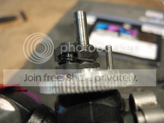

I installed dynamite aluminum clutch shoes and a mugen spring. When installing I couldn't get the spring to fit into the clutch nut grooves. Do I need a different nut? The springs rest above the groove. I installed the shoes with the dynamite logo visible. Any ideas? Thanks!
I found when installing this set up that the spring are a PITA to get into the collet grove. Just use a flat head screw driver and push them down into the grove. Once they are in they wont come out.
here are some pictures of the springs and shoes.
From what i'm reading this is what you see
and this is what it should look like
hope this helped
Savage you are the man!! I was going crazy thinking my shoes were on backwards but thinking they wouldn't work that way. I was racking my brain. Didn't think that the springs needed to be slanted. You're a lifesaver
Yeah it took me a while to figure it out when i installed this springs and shoes.
Thought i had the springs or shoes upside down :)
