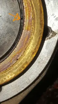

I found an interesting article on piston ring gaps.
Haven't measured mine, but from a simple visual inspection, the gap is huge. I have noticed som scratch marks on the inside of the sleeve, and thought these might be causing loss of compression resulting in the engine not running. But having noticed the size of the piston ring gap, the scratches really cannot have any impact what so ever.
So the question then is, what is a correct gap size for this engine.
Looking at rules of thumb for piston ring gaps, the gap on this engine ought to be 0,10 - 0,15 mm. I'd say mine is atleast twice that.
