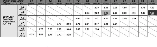

hello, i have a savage truck i converted from a 4.6 to a flux. everything fit to well but now its burning the spur gear clutch.
I'm using all stock parts on the truck except for tires BIG JOES 3.8 on all 4. a new mamba monster x with a 2250kv uncensored motor. the truck must weigh around 15 to 20 pounds.I'm running on two 50c 3 cell LiPos to total 6 cells.
the spur gear is also stock @ 52T the pinion gear is metal at 16T.
i would appreciate some expert advice on a new ceramic clutch pad and maybe different size gears. to run cooler but still have enough power and speed.
thank you all before hand. pic included in post

What actually is burning, the friction pad?
Have you tightened the slipper nut all the way?
Tried different gear ratios if this was the cause of swelling lipos?
Yep make sure to crank that slipper nut all the way down. You want no slip. Any slip and you will cook it.
Also make sure theres no binding anywhere else in the drivetrain. Any binding will just add to the problem, make sure everything spins nice and free
Thank you all for your advice I will try that new gear set up. And the nut has been tight but I guess it comes loose with the torque. I will also check everything to be spinning nice and smooth. ???
