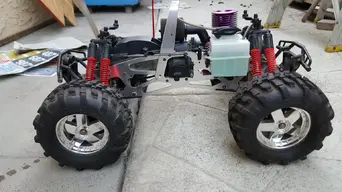

This truck was given to me. I'm faily new to this rc world and i like it. So I'm thinking everything is stock on my truck. That's why I'm just asking what is good out there. I was actually looking into getting the LRP28.
This is my truck

What spur/clutchbell do you have now? I don't know what "stock" is as I've never had a "stock" savage. You can count the teeth on the bell and the spur should have a number stamped into the front of it somewhere.
Oh, I thought you were wanting to buy something new, not ask if what you had installed already will work ok.
Yes, it should work ok.
If it runs ok (doesn't over heat) and shifts ok but seems to top out pretty quickly while the engine sounds like it can take more, then try a smaller spur like a 49T and see how it does.
The grey boxes are combinations that will fit the chassis. So, you can use a 49/52 spur with a 15 bell.
