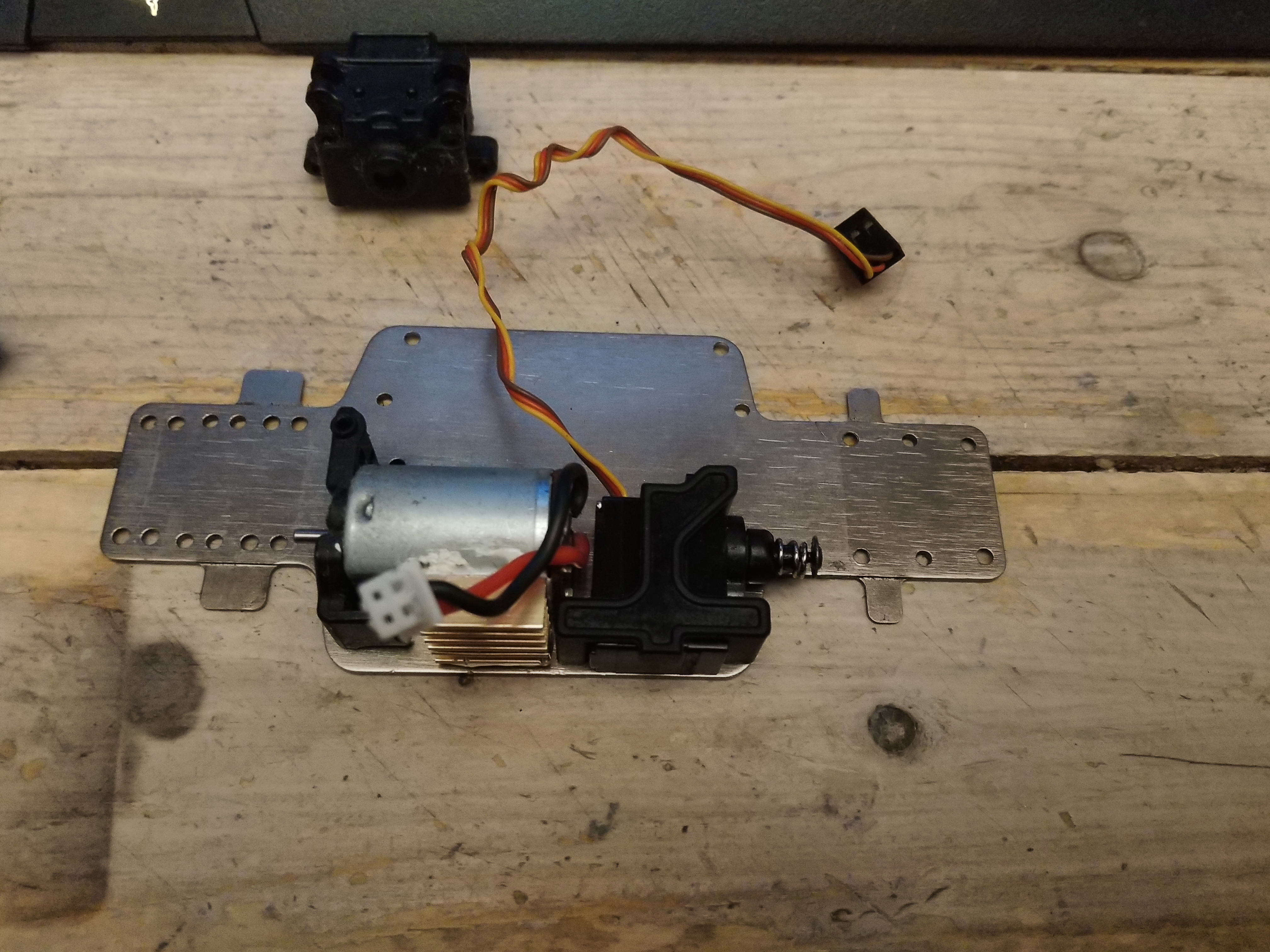

Motor
Either way, I wanted to get a new one, as the old has seen alot of action, and has a heatsink glued to the side that I can't get off..
I think my next weakest parts, will be the plastic gears for the center shaft, and the motor, I haven't been able to source metal replacements.

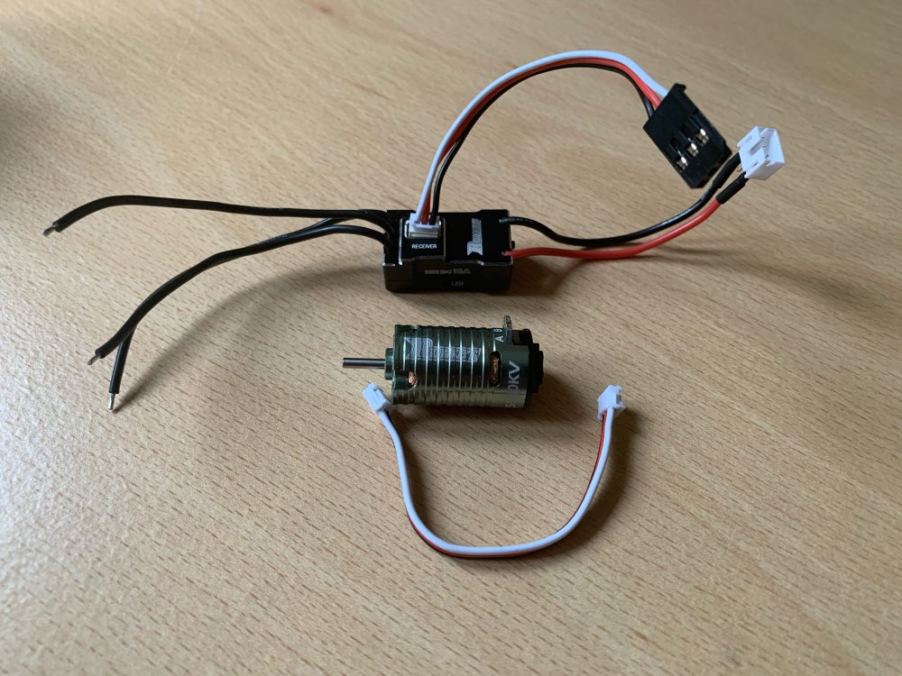

Phew, stock motor, is 2.5 cm long, aka 25mm... The new one is 25mm long...
I was a bit worried when the description for the stock motor was 90 mm
It's a tight squeeze as it is :D
I think the screw holes should be the right distance as well, the diameter of the new motor is also smaller than the stock one...
I guess the gearing is the next thing... The stock motor has a 17T gear, I suspect that's way to big for the brushless one... So I found a 16T brass gear, with similar thickness and roughly the same diameter.

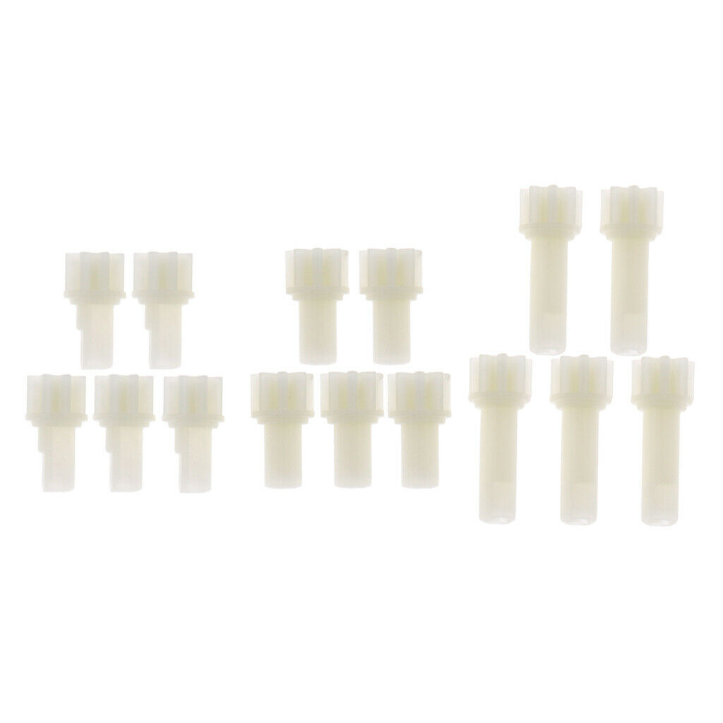

I was told these break all the time, though I never had that issue, I've ordered some replacements.
Spurr & Diff gears

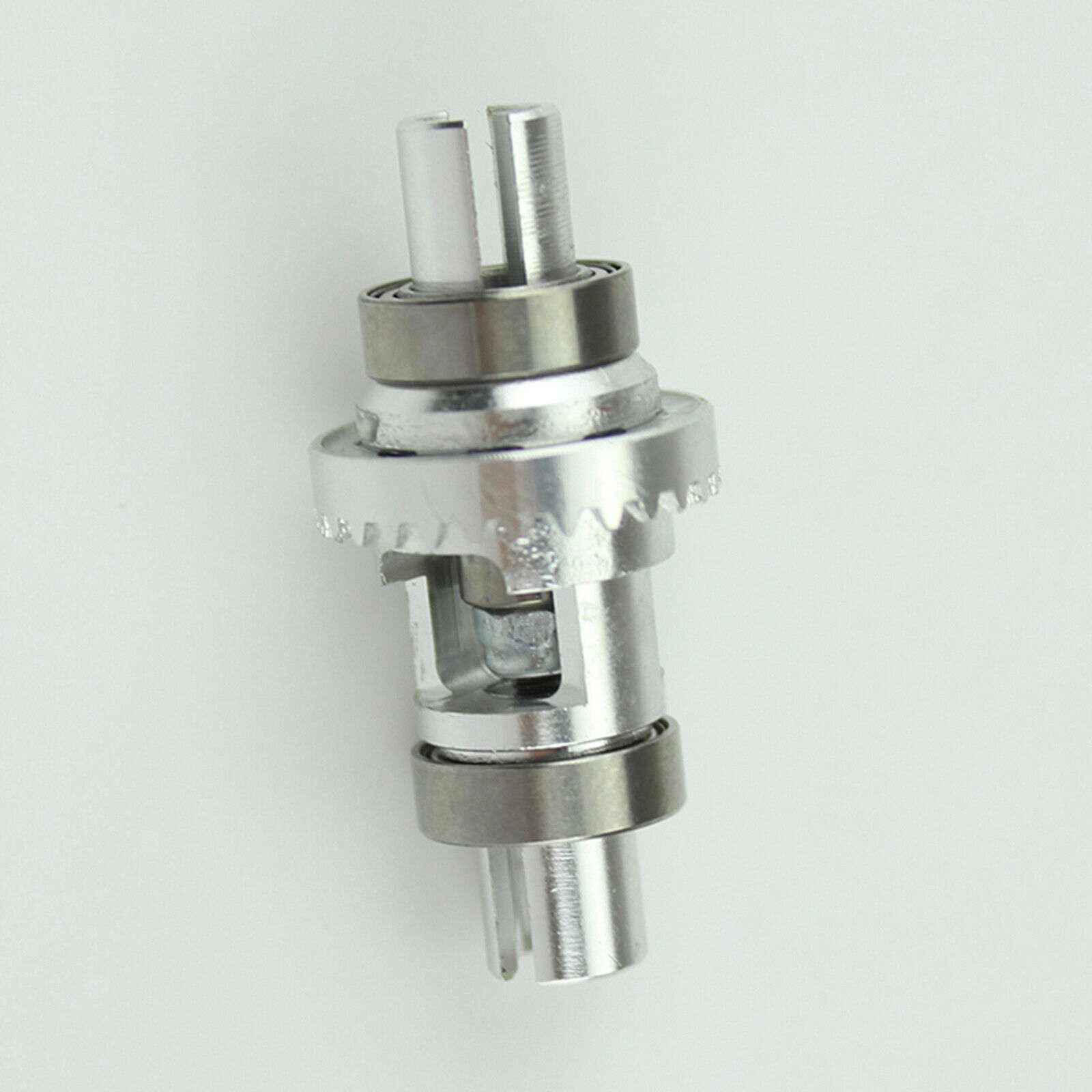

There are some issues with the new Differentials though, they may be made for the Mini-Z, this means they require longer driveshafts, the cups are shorter than stock , though the listing says they are for the K989. Missing too many parts to see for sure if it will be an issue.
They also bind up the center shaft somewhat, so I need to investigate how to fix that.
SantaClaw
146
North of Norway
So, after spending an hour or so, sanding down a washer to make 1 shim for one of the new diffs... I seriously hate whomever made these... lol
I first had to drill a 5mm id washer to 6mm, then I had to sand it down, to about 1/3'rd thickness for it to fit 1 of the diffs... Without shims, there is WAY too much slack in the diff gears, to the point where the brand new gears can skip...
I do NOT recommend buying any of the K989 branded ball diffs. Get one for the mini-z and get two long wheelbase cv shafts (10,5mm) for the same car....

I did try the new motor out today, I've got it hooked up to a switch under the car, so you don't have to disconnect the battery or remove the body to do so, the ESC is TINY, I connected it to a HPI reciever just to test it out, and the motor/drivetrain works great, the new diffs are in, and they work just fine, I had to modify the holes in the motor mount a tad, but otherwise it fits nicely.
The motor ran sweet, very silent.
